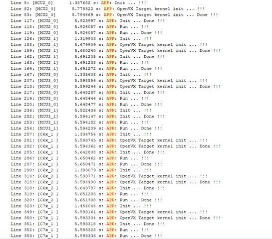

    From the remote core logs (i.e. [MCUx_0], [C7x_y ] ), Do you see all the logs being printed when you run the vision_apps_init.sh?
    i.e. Are all the cores reaching "App: Run ... Done" ?

    From the shared logs, I see all the cores are initialized and reached "App run".
    1. Since you mentioned that this phenomenon is not occurring every time, Could you confirm in the Cores reach "App_run" when the IPC communication fails?

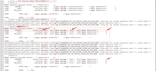

    The log screenshot above is after the application failed to receive the frame rate. After 71462 seconds, ipc_test was run to test the IPC communication. It was found that the communication failed at this time. There is no way to know at this moment whether MCU2_0 is running.

    Ok, so that is good. In this case, could you get the capture stats printed once the issue occurs?
    In the multicam graph, when you press "p" (while running in interactive mode), it should print out the stats from the csi-rx. Could you share the same when the issue occurs?
    Only the capture stats in this case would help us identify what is the issue that is occuring here.

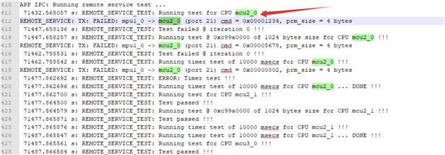

  • HI TI

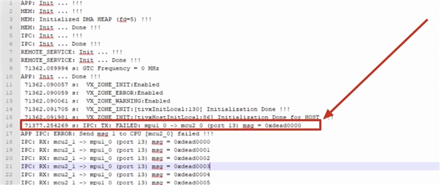

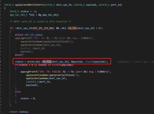

    When a problem occurs, the IPC code will display the following error. May I ask what is causing this
    Could you enable APP_IPC_DEBUG macro in the file app_ipc_rtos.c and app_ipc_linux_priv.h present in vision_apps/utils/ipc/src/ folder.
    With this you could get more logs from the IPC transaction.
    If you have already run ./vision_apps_init.sh , then you would get the ipc logs from remote cores as well after enabling this macro.
    What do capture stats refer to and what logs are they?
    Capture stats logs would give you an idea on why the hang on the video stream occured (i.e. there is crccount which increases if the sender is faulty, then there is overflow flags, and frame drops could be seen if any etc)

    This is the IPC related log we obtained
    APP: Init ... !!!
    MEM: Init ... !!!
    MEM: Initialized DMA HEAP (fd=5) !!!
    MEM: Init ... Done !!!
    IPC: Init ... !!!
    IPC: Init ... Done !!!
    REMOTE_SERVICE: Init ... !!!
    REMOTE_SERVICE: Init ... Done !!!
     71362.089994 s: GTC Frequency = 0 MHz
    APP: Init ... Done !!!
     71362.090057 s:  VX_ZONE_INIT:Enabled
     71362.090059 s:  VX_ZONE_ERROR:Enabled
     71362.090061 s:  VX_ZONE_WARNING:Enabled
     71362.091705 s:  VX_ZONE_INIT:[tivxInitLocal:130] Initialization Done !!!
     71362.091981 s:  VX_ZONE_INIT:[tivxHostInitLocal:86] Initialization Done for HOST !!!
     71377.254269 s: IPC: TX: FAILED: mpu1_0 -> mcu2_0 (port 13) msg = 0xdead0000
    APP IPC: ERROR: Send msg 1 to CPU [mcu2_0] failed !!!

     71432.568057 s: REMOTE_SERVICE_TEST: Running test for CPU mcu2_0 !!!
    REMOTE_SERVICE: TX: FAILED: mpu1_0 -> mcu2_0 (port 21) cmd = 0x00001234, prm_size = 4 bytes
     71447.658136 s: REMOTE_SERVICE_TEST: Test failed @ iteration 0 !!!
     71447.658257 s: REMOTE_SERVICE_TEST: Running test @ 0xc99a0000 of 1024 bytes size for CPU mcu2_0 !!!
    REMOTE_SERVICE: TX: FAILED: mpu1_0 -> mcu2_0 (port 21) cmd = 0x00005678, prm_size = 4 bytes
     71462.758531 s: REMOTE_SERVICE_TEST: Test failed @ iteration 0 !!!
     71462.758542 s: REMOTE_SERVICE_TEST: Running timer test of 10000 msecs for CPU mcu2_0 !!!
    REMOTE_SERVICE: TX: FAILED: mpu1_0 -> mcu2_0 (port 21) cmd = 0x00000002, prm_size = 4 bytes
     71477.862692 s: REMOTE_SERVICE_TEST: ERROR: Timer test !!!

    What is the reason for the error in the log?
    As mentioned above, please run this scirpt before and then take the ipc application logs, to get error logs from [MCU2_0].
    Since you have enabled the macro in rtos side too, you should get some logs from [MCU2_0] when running the IPC application. Please let me know if you already tried this?
    Nikhil
    Please share this data too.
    Also when there is a hang in the multicam application, is it possible to check where exactly is the hang? It would be great if you could setup a debugger here.
    Nikhil
