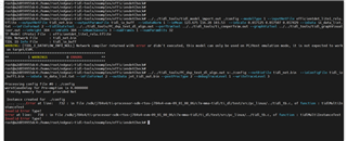

  • HI,
    PFA.
    While running the inference, I was getting this issue.
    ../tidl_tools/tidl_model_import.out ./config --modelType 1 \
    --inputNetFile efficientdet_lite1_relu.tflite --outputNetFile tidl_net.bin \
    --outputParamsFile tidl_io_buff  --inDataNorm 1 \
    --inMean 123.675 116.28 103.53  --inScale 0.017125 0.017507 0.017429 \
    --inData in_data_list.txt --inFileFormat 2 \
    --tidlStatsTool ../tidl_tools/PC_dsp_test_dl_algo.out \
    --perfSimTool ../tidl_tools/ti_cnnperfsim.out \
    --graphVizTool ../tidl_tools/tidl_graphVisualiser.out \
    --inHeight 384 --inWidth 384 --inNumChannels 3 --numFrames 1 --numParamBits 32
    ../tidl_tools/PC_dsp_test_dl_algo.out s:./config \
    --netBinFile tidl_net.bin \
    --ioConfigFile tidl_io_buff1.bin \
    --outData jet_tidl_out.bin --postProcType 1 --debugTraceLevel 1 --writeTraceLevel 3

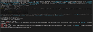

  • Hi Pratik,
    This is the log for 8 bit.
    root@d38037a37d2c:/home/root/efficiendetCheck# ../tidl_tools/tidl_model_import.out ./config --modelType 1 \
    --inHeight 384 --inWidth 384 --inNumChannels 3 --numFrames 1 --numParamBits 8
    TF Model (Proto) File  : efficientdet_lite1_relu.tflite
    TIDL Network File      : tidl_net.bin
    TIDL IO Info File      : tidl_io_buff
    Empty prototxt path, running calibration
    ~~~~~Running TIDL in PC emulation mode to collect Activations range for each layer~~~~~
    Processing config file #0 : /home/root/efficiendetCheck/config.qunat_stats_config.txt
     Freeing memory for user provided Net
     .... .....Error at line:   733 : in file /ti/SDK_9_1/J784S4/ti-processor-sdk-rtos-j784s4-evm-09_01_00_06/c7x-mma-tidl/ti_dl/test/src/pc_linux/../tidl_tb.c, of function : tidlMultiInstanceTest
    Invalid Error Type!
    Error at line:   739 : in file /ti/SDK_9_1/J784S4/ti-processor-sdk-rtos-j784s4-evm-09_01_00_06/c7x-mma-tidl/ti_dl/test/src/pc_linux/../tidl_tb.c, of function : tidlMultiInstanceTest
    Invalid Error Type!
     *****************   Calibration iteration number 0 started ************************
    Invalid Error Type!
    Invalid Error Type!
     *****************   Calibration iteration number 0 completed ************************
    ------------------ Network Compiler Traces -----------------------------
    NC running for device: 1
    Running with OTF buffer optimizations
    successful Memory allocation
    terminate called after throwing an instance of 'std::out_of_range'
      what():  map::at
    Aborted (core dumped)
    TIDL ALLOWLISTING LAYER CHECK: TIDL_E_QUANT_STATS_NOT_AVAILABLE] tidl_quant_stats_tool.out fails to collect dynamic range. Please look into quant stats log. This model will get fault on target.
    **          0 WARNINGS          1 ERRORS          **

  • Hi Akhilesh,
    Thank you for your kind patience.
    Here is an update on efficientDet issue,
    There were few things wrong the way you were importing the model as mentioned here,
    For example, modelType was set to 1, this is for onnx however the model that you were using was tflite so it should have been set to 3 and few more, nevertheless i tried those experiments by my own, so you dont have to share anything as of now.
    I tried doing few experiments with efficientdet_lite1_relu.tflite on 9.1.6.0 tidl tools version, with some internal flags and moreover i can confirm that there is possibility of issue in convolution layer, specifically from data flow or compute flow on target side.
    I can also confirm that ref kernels are working fine(host emulation) but underlined issue is visible in dma, intrinsic level (target side aspects of model execution)
