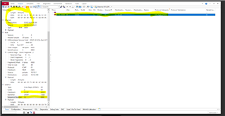

I need to know why is the ICMP size is limited to 60 bytes , please support if there is any option to increase the packet size to be 64 bytes .

Can you please share the packet capture as well (from Wireshark)

Hello ,
we use the AUTOSAR MCAL ,
about the 60 bytes, I attached a screenshot of the ICMP test , please check the top left marker .
It could due to the CRC of Ethernet packet (4 bytes) removed by NIC while passing to application.
You can check byte count from CPSW External port Tx byte count (octet count) statistics, how many bytes transferred by CPSW.
Similarly we have Rx byte count (octet count) as well.
Send only ICMP request and check above CPSW Tx, Rx statistics counter of octet count will provide you the no.of bytes the packet has.

This check box must be enabled to add the 4 bytes of the CRC and then the total packet size will be 64 instead of 60?

I mean send ICMP request from Test PC to TDA4VL CPSW and check Rx Statistics of CPSW and for response check Tx statistics of CPSW.
Please refer to TRM (Register details) from SOC page, for the information about CPSW statistics.
