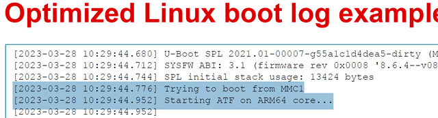

but it is very fast in the demo document.

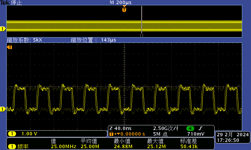

Customer measured the eMMC clock is 25MHz only, not working at HS200.

    The boot time improved with the patch(too exciting to click the resolved buttom), but still doesn't meet expectration, then probed the eMMC clock,  it is still 25MHz, confirmed by both customer and me with osillocope.
    Same eMMC clock frequency, but improved boot time, maybe the patch solved clock setting, but not configure to right frequency.

  • Hi Tony,
    The clock would be 200MHz only when sending/receiving DATA to/from the eMMC device. But it would be 25MHz when idle or sending eMMC CMD.
    So when probing the clock, please also probe the CLK line and DAT0 line to ensure you are check the clock at the DATA phase, not CMD phase.

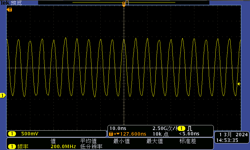

  • Bin,
    Yes, I captured 200MHz clock with Pulse trigger.
