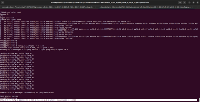

Goal : Load and execute IPC application to understand the process of IPC
What works :
- Compile the IPC app by using "make -s BOARD=j784s4_evm CORE=c7x_1 BUILD_PROFILE=debug ipc_echo_test_freertos"
What did I try :
I've tryed the same manip with different core / i've also try with the app ipc_echo_testb_freertos
I've followed this doc to try to make it works : 4.8. IPC — Platform Development Kit (PDK) - J784S4 User Guide (ti.com)
What doesn't work:

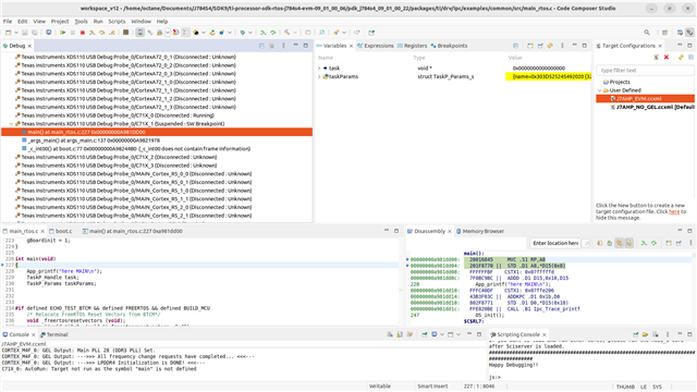

On C7x core :
        - Load & run the executable using sd card boot mode. The core starts running but never reaches "Main"  and we paused, CCS errors appears
        - Load & run the app in no boot mode. The programm looks to load correctly using CCS but when I run, I can't see anythings working even in terminal or in console

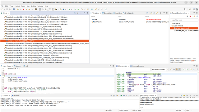

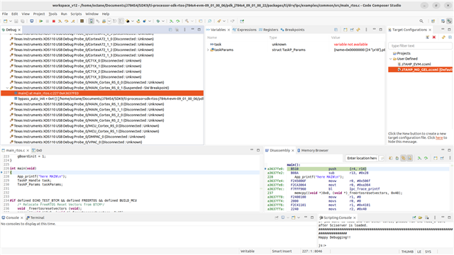

On R5F core :
        - Load & run the executable using sd card boot mode. The programm looks to load correctly using CCS but when I run, I can't see anythings working even in terminal or in console
