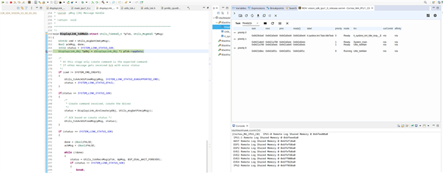

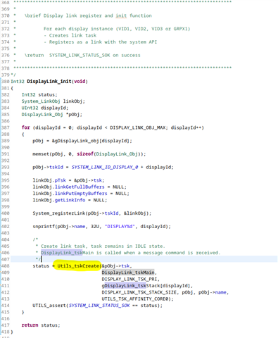

This is the ISS Use Case graphic I'm currently running. The individual links are what I really am interested in taking a look at. For example Display_Video; after putting breakpoints in the displayLink_tsk.c file displayLink_init, I should be in theory able to visualize the task running.

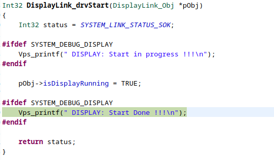

Utils_tskCreate is what I assume to be the general wrapper function intended to create all links when specified with the correct LINKNAME_main function. This breakpoint however is skipped. After setting another one in the display_Main function and stepping through I reached this point:
I assume "DISPLAY: Start Done" UART message signals that everything regarding the display initialization is finished and that the task itself exists, therefor I should see it if I press step over until I exit. However, the ROV only shows me following after pausing on IPU0_1:
detailed ONLY shows the idle loop.
ReadyQS shows following:
I understand why Utils_tskMain is showing, probably because it is the wrapper for all the links the same way that the Utils_tskCreate is? But I should be seeing all the other links running as well.
