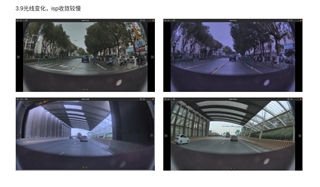

In SDK 8.6, AM62A ISP uses non-fixed exposure (100~33000us), and the image is blue. With fixed exposure (11ms), the image is normal. Any suggestions? Thank you! AE log is as follows:

Hello Yangrongbo,
When you had non-fixed exposure time (100~33000us), was the image brightness okay? Can you print out the exposure time calculated by the 2A algorithm?
When you tuned AWB, did you use fixed exposure or automatic exposure?
Thank you.
Jianzhong

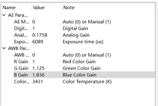

HI, Jianzhong,
When I tuned awb, I use fixed exposure. The exposure time calculated by 2A algorithm is as follows:
In addition, how to set H3A_INPUT_LSB appropriately, 2 or 4?
It is typically around 2~6.
You may start with 4 and adjust if necessary.

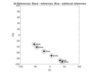

Hi Yangrongbo,
The calibration plots look fine to me.
That is probably why you don't see any issue with 11ms exposure time.
What is the condition for the images to be blue?
Could you please share the sensor companding knee points and some raw images in failure case?
Hi yangrongbo,
I cannot tell for sure if anything is wrong in your AWB calibration although the calibration plots looks reasonable.
It might be either that 2A runs too slow in your system or AWB calibration is not done properly.
Camera app in TI SDK is a demo program that is not tested and tuned for complex road test conditions.
You will have to check if the issue happens because AE/AWB are slow in response to lighting condition changes.
Then, you may have increase the frame rate of AE and AWB as necessary.
You may also refer to IMX623 reference tuning and AE/AWB setting changes Sony did for TDA4 in the link below.
| IMX623 | 1 | Sony module w/ SR1069A Lens | Please contact Sony for SDK 8.1 driver Registration flow | Developer World (sony.com) |
