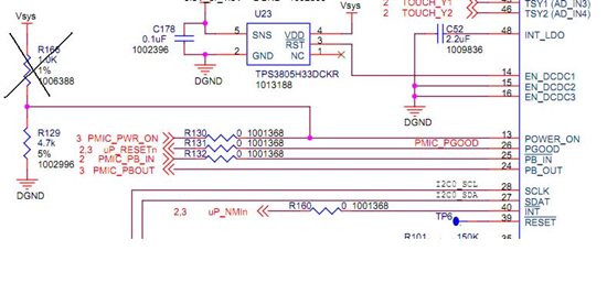

We designed PCB board with OMAP-L138 supplied by TPS65070. We connected TPS65070 to OMAP-L138 as in OMAP L138 SOM M1 scheme:
As you see the POWER_ON signal is always pulled-high, so we  removed R166 resistor. The PMIC_PWR_ON is connected to OMAP-L138 GPIO2[2] signal.
1. Is is possible to control the state of POWER_ON signal by U-Boot (when the OMAP-L138 is starting) in order to sustain TPS65070.
2. Is it possible to control  the state of POWER_ON signal by Linux (when the system is shutdown by "poweroff" or "shutdown now" Linux shell command) in order to switch-off TPS65070?
