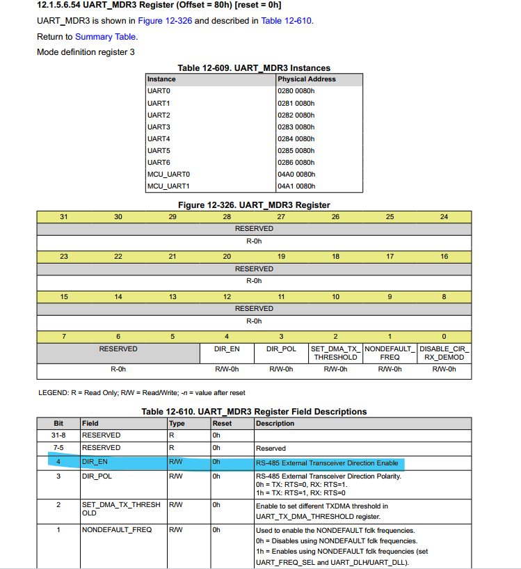

I am evaluating the RS485 over UART5 module on R5 core of starter kit. As of now  i have imported UART example from MCU+SDL v9.1.00.41 and one more UART peripheral is added (ie. UART5) for RS485.
In TRM it is mentioned that to select a RS-485 mode, we need to set the UART_MDR3[4] DIR_EN bit field to 0x1 but if i check in low level driver files  I am  not getting any specific APIs to change the UART_MDR3 mem registers of UART.
How should we configure the UART for RS485 to work.

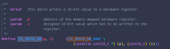

  • Hello Shraddha,
    Yes I went through your concern.
    I am just wondering that if you need to write to a register then a basic low level CSL API would suffice.
    I am attaching a API here with its description.
    This should be able to write a desired value to a specific register.
    Let me know if this helps.
    Looking forward to your response.
    Vaibhav

  • Hi Shraddha,
    couple of points...
    1) as the TRM indicates RTS signal will be generated by HW if you set DIR_EN bit. So no need to control RTS manually on AM64 side.
    2) There is also a polarity config for RTS (see TRM table 12-610, DIR_POL). This needs to be aligned with your RS-485 transceiver card direction signal.
    3) Here I would assume UART5_RTS is connected to some direction signal as in TRM drawing. Why do you connect this to ResetEn signal? Do you have schematics of your RS-485 card?
    4) I assume UART echo example is not perfect for RS-485. On RS-485 you can not send and receive at same (only half-duplex comms). So the direction for the communication has to be controlled by some higher level protocol or you may get bus contention.
    Keep in mind that our UART driver and examples are designed and tested with full duplex UART in mind. We have not tested that with RS-485 mode. I assume due to the missing transceiver on the EVMs. Still it should work if you make sure that both sides are in sync on who can send at any time. And the HW is connected correctly.
    Regards, Frank
  • 12.1.5.4.8.2 RS-485 Mode
    12.1.5.4.8.2.1 RS-485 External Transceiver Direction Control
    The UART_MDR3[4] DIR_EN bit enables hardware control over an external transceiver to support RS-485. The
    direction signal comes across the DIR port. The direction polarity is controlled by the UART_MDR3[3] DIR_POL
    bit. The direction is determined by the hardware monitoring the TX FIFO and the TX shift register. When both
    are empty the transceiver is set to RX. There is a guard band delay counter of 3 bit clock cycles after the TX
    shift register is going empty to allow time for the stop bit to transition through the transceiver before a direction
    change to receive might be applied.
    This is how RS-485 mode works. Also keep the timing in mind (fig 12-271)
