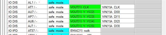

The .dat file output of the Pin Mux Utility for the DM816x doesn't match the selection in the gui.
For example:
Translates to:
Pad 1 CYG AL1 - safe_mode 4 SafeMode Reserved Reserved Reserved 1 2
Pad 1 CYG AT7 - safe_mode 4 NotSelected Selected NotSelected Reserved 1 2
Pad 1 CYG AU7 - safe_mode 4 NotSelected Selected NotSelected Reserved 1 2
Pad 1 CYG AP7 - safe_mode 4 NotSelected Selected NotSelected Reserved 1 2
Pad 1 CYG AU6 - safe_mode 4 NotSelected Selected NotSelected Reserved 1 2
Pad 1 CYG AJ7 - safe_mode 4 NotSelected Selected NotSelected Reserved 1 2
Pad 1 CYG AT37 - safe_mode 4 SafeMode NotSelected Reserved Reserved 1 0
This is with version 1.1.5.0.
Is there a newer version?
Tim.

    The purpose of the DAT file is to save your work (the current state of the GUI).  When this file is read into the tool
    the state of the GUI is restored (File -> Load -> Design).
    The output file is correct.  It is interpreted this way:
    Pad = This line defines one pad of the die
    1 CYG AL1 - = There is 1 pkg type (CYG).  The top ball location is AL1.  There is no top ball.
    safe_mode = The mode 0 signal name for the ball.
    4 NotSelected Selected NotSelected Reserved = States of the 4 mux mode cells.  Mode 1 is selected.
    1 2 = 1 parameter value follows.  Value is 2 which corresponds to pullup disabled.
    Michael T

  • Michael,
    I still seems broken to me.
    In the GUI I have VOUT[1]_CLK selected for PAD AT7, but the .dat file s
    However, in the GUI I have VIN[0]A_CLK select for PAD AR14 and I get the expected:
    Pad 1 CYG AR14 - VIN[0]A_CLK 4 Selected Reserved Reserved Reserved 1 0
    So it works in one case but not the other.
    Tim.
  • Tim:
    The DAT file is not really meant to be a file for the user to use as his "results" from using the tool.
    It is just in a format that allows the state of the GUI to be saved and restored.
    Is actually correct.
    safe_mode = Mode 0 signal name
    NotSelected Selected NotSelected Reserved are the states of the 4 GUI cells.
    Which means the mode 1 is selected = VOUT[1]_CLK
    As long as you can do File -> Save -> Design and File -> Load -> Design
    and the GUI gets restored correctly, it is working correctly.
    Michael T
    PS: Please mark this post as answered via the Verify Answer button below if you think it answers your question.  Thanks!
  • Tim:
    Now I understand your point.  The purpose of the first part of the output is to identify which device ball is represented
    by the text on this line.  So it shows the ball ids for every package and it shows the "Mode 0 signal name" which is
    safe_mode for this ball.  It does not mean safe_mode is selected by the GUI.
    This way the lines in the DAT file can be in any order.  The tool reads each line and uses the ball ids and Mode 0 Signal Name to
    associate the data with the correct device ball.
    Michael T
