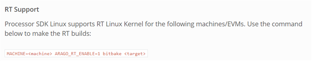

But these instructions only build normal Linux images.
How can I build the RT-Linux images?
  • But these instructions only build normal Linux images.
    As per https://software-dl.ti.com/processor-sdk-linux/esd/AM65X/09_01_00_01/exports/docs/linux/Overview_Building_the_SDK.html#build-options this is usually done like this:

  • I have added the RT build instructions to the CICD report page.
