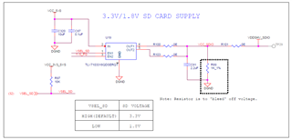

    After a bit of analysis, i presume the initialization error is because of the voltage mismatch on the SDIO lines. My SDIO card is configured to operate in 1.8v for SDIO lines to support UHS data rates. But from the schematics, I could see SDIO lines are pulled up to 3.3V by default and is controlled by VSEL_SD pin to support voltage switching between 3.3 & 1.8V.
    I could see VSEL_SD is mapped to GPIO0_31 and mentioned in the device tree node as follows. I presume the driver make use of this pin to dynamically switch between 3.3 and 1.8V.

    Question:
    1. How to drive VSEL_SD to low always so that 1.8V is chosen default for the SDIO lines instead of 3.3V?

  • Hello Bin. Thanks for your reply. Yes, the above change in the device tree ties the SDIO lines to 1.8V but unfortunately my original error still persist "mmc1: error -110 whilst initializing SDIO card".
    But Wi-Fi module is successfully detected and initiated when i use 3.3V SDIO line voltage by forcing through device tree with no-1-8-v property.   Any reason for this behavior?

  • Hello Bin,
    NXP's 88W9098 (Murata 2XS) module supports both 1.8 and 3.3V(non-standard) SDIO operation.  It cannot dynamically switch between 1.8 and 3.3 but appropriate resistor strapping has to be done in the hardware to switch between these modes. UHS modes are not supported in 3.3V but you can still operate at SD high speed with 3.3V SDIO operation.
    I already brought up the module with 3.3V supporting SD high speed and now I am trying the bring up the module with UHS speed at 1.8V SDIO.
  • Hi Kousik,
    How is the module UHS mode enumeration process expected to be? Is it same as SD cards which initially expect the IO to be 3.3v then switch to 1.8v for UHS mode? Or the WIFI module expects the IO should be started from 1.8v at the beginning and never use 3.3v at all?
