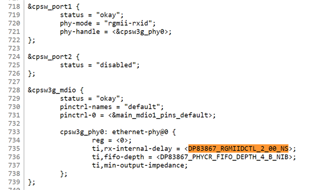

Hi Expert,
customer are configuring the phy Marvell's 88q2112.
Now it is normal to work at 100M transceiver, but 1000M is not normal. customer need to configure the rgmii delay parameter. Where can customer adjust this parameter? and how to modify it?
