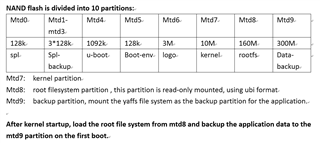

Hello everyone,
The previous file system saved on the SD card may be damaged, so a backup plan is proposed to backup some important data from the SD card to flash, and the file system is also transferred to flash.
We create UBI file system on NAND flash as linux root filesystem,and added a partition on NAND Flash for backup purposes.
It works several days, suddenly one day after we reboot, the kernel cannot mount ubi filesystem, I got following errors in kernel log:

[    1.431644] Creating 10 MTD partitions on "omap2-nand.0":
[    1.437333] 0x000000000000-0x000000020000 : "SPL"
[    1.444134] 0x000000020000-0x000000040000 : "SPL.backup1"
[    1.451519] 0x000000040000-0x000000060000 : "SPL.backup2"
[    1.458866] 0x000000060000-0x000000080000 : "SPL.backup3"
[    1.466027] 0x000000080000-0x000000260000 : "U-Boot"
[    1.473577] 0x000000260000-0x000000280000 : "U-Boot Env"
[    1.480722] 0x000000280000-0x000000580000 : "LOGO"
[    1.488648] 0x000000580000-0x000000f80000 : "Kernel"
[    1.499558] 0x000000f80000-0x00000af80000 : "root"
[    1.571249] usb 1-1: new high-speed USB device number 2 using musb-hdrc
[    1.579886] 0x00000af80000-0x000020000000 : "cache"

So, Could you please help us to analyze what caused this problem - unable to mount UBI file system from nand flash?
Junwei
  • Looks like something fails during ubi mounting, which then leads the Kernel being unable to mount the roots, and the boot to fail.
    I noticed you are using a very old Kernel and software stack. Much has happened since, and the driver stack has been much improved, including around MTD/Flash handling. Can you see if you can re-create the issue based on our current production software stack? It's based on Kernel 6.1... See https://www.ti.com/tool/PROCESSOR-SDK-AM335X
    Regards, Andreas
  • Hello Andreas, if we upgrading to the latest kernel version, the change momentum is too large, and will bring relatively high risks to the project.
    Could you provide some suggestions based on the current kernel version_3.2.0 ?  Is it possible that our partition scheme is causing this problem?
    B & R, Junwei
  • if we upgrading to the latest kernel version, the change momentum is too large, and will bring relatively high risks to the project.
    Understood but how about you do a "quick / minimum" port just for the sake of running some Flash related experiments.
