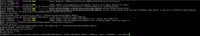

Customer verify Video encode/decode feature on SK-AM69 board with .mp4 file, it is ok to do H.264/H.265 with 2K resolution .mp4 file.
But with 4K .mp4 file, report erro as below:
gst-launch-1.0 filesrc location=./20240229095126003_000.mp4 ! qtdemux name=demuxer demuxer.! h265parse ! queue ! v4l2h265dec  ! autovideosink

    I believe there may be some limitation with the qtdemux plugin. I was able to successfully decode with 720p and 1080p but the provided 4k stream fails. I will test with another 4k stream and let you know the results.

    I believe this problem may be with the color parameter of the stream. In general what is the encoding process that you are using to get this stream? What camera is being used for the capture and do you know if the stream is encoded with 10-bit color depth? The stream has a color parameter of bt2020 which suggests that it being encoded with 10-bit or 12-bit color depth. Our IP only supports 8-bit color and I haven't had any success overwriting this bt2020 color parameter for a successful decode.

    We have root caused the issue and it is due to the video format. However, this is not a driver issue. It is a gstreamer v4l2 plugin limitation. The driver has the capability to support bt2020, but the plugin itself does not expose this capability which is why you are seeing this linking error.
    The colorimetry code being exposed by qtdemux is colorimetry=(string)2:6:0:7 whereas the list of supported colorimetry by the v4l2 plugin is colorimetry=(string){ bt601, smpte240m, bt709, 1:3:5:1, 2:4:5:2, 2:4:5:3, 1:4:7:1, 2:4:7:1, 2:4:12:8, bt2020, 2:0:0:0 }. qtdemux is setting a certain colorimetry on the src pad that the downstream elements don't have support for, therefore linking will fail. To be clear though, this list of supported colorimetry is not coming from the driver, but the gstreamer plugin itself.
