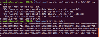

HI, expert
I use python to parse uart log from HS board but failed. I want to know the keywriter status. Please share some ideas.

02000000011a00006a376573000000000000000048534653010101000101010002a6000000000000aa1f8e3095042e5c71ac40ede5b4e8c85fa87e03305ae0ea4f47933e89f4164aeb5a12ae13778f49de0622c1a578e6e747981d8c44a130f89a336a887a7955eead0bc40b000000000000000000000000000000000000000000000000000000000000000000000000000000000000000000000000000000000000000000000000b2f444d672d266087b928ae73b24d926fb582079c178750e5f9961f63ff2db65C
