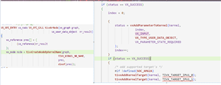

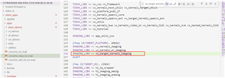

        We now have an algorithm that needs to be implemented in the code, but encountered an error when creating nodes.
The error log is as follows:
50.514953 s:
VX ZONE ERROR:[tivxCreateNodeByKernelName:134]
Calt
50,514963 s:VX ZONE ERROR:[vxGetstatus:1015] Reference
NULI
[NR MODULE] Unable to create NR node!
to vxGetKernelByName failed; kernel may not be registered
VR
graph done!
App Run Graph Done!
Capture delete done!
VISS delete done!
AEWB delete done!
done!
Img Mosaic delete
50.515008 s:
VX ZONE ERROR:[ownReleaseReferenceInt:601] Invalid reference
Please help analyze. Thanks!

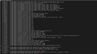

    Please send the full application logs and the remote core logs (i.e. by running ./vision_apps_init.sh before running the application)
    Nikhil
  • Hi Nikhil
         This is the latest log

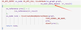

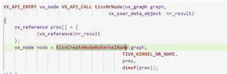

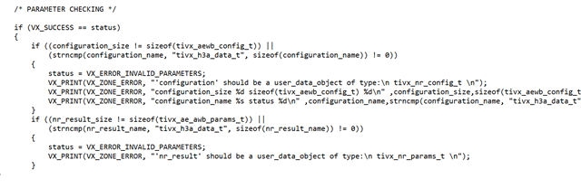

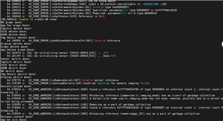

    As per your latest log,
    57.371718 s: VX_ZONE_ERROR:[vxFinalizeKernel:473] Invalid kernel signature type
    57.371763 s: VX_ZONE_ERROR:[vxLoadKernels:207] Publish function for module hwa failed
    The HWA loading has failed. Please let me know your modifications here.
    It says that the signature type is not a valid OpenVX data object.
    From your earlier log, it seems that you are adding your node into the HWA module. I would suggest adding it as separate module instead of combining with the HWA module.
    Nikhil
  • HI Nikhil
           I re-added it according to your suggestion, but it still failed. The source code and log have been uploaded. From the log, it appears that the kernel was set to null, causing the registration of the node to fail.
    [com COM14] (2024-03-14_175621) COM14 (USB Serial Port (COM14)).logkernels.rar
    thanks!

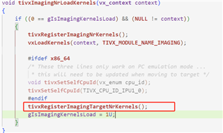

    I believe you have called into this API in the application right?
    tivxImagingLoadKernels()
    This would do the host side registration of your node. Since your target is also A72, inside this API, there is tivxRegisterImagingTargetAewbKernels() which is target side registration, currently under the macro x86_64
    You would have to put this outside the macro, so that the target side registration of the node happens on A72.
    Nikhil

    and When placing the API tivxRegisterImagingTargetAewbKernels() under X86_64, compilation errors will occur.
    The library name for your kernel is "vx_target_kernels_imaging".
    Have you included this in the main concerto file of vision_apps for A72? (i.e. in concerto_mpu_inc.mak in vision_apps/apps folder)
    Nikhil

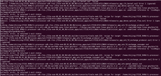

  • Hi Nikhil
       After  I added  "vx_target_kernels_imaging" library in  concerto_mpu_inc.mak in vision_apps/apps folder,compilation errors will occur as below.if I didn`t  add,it reports undefined reference.
  • Hi Nilhil
             Now the compilation problem has been solved, but there are still further errors in function "vxSetParameterByIndex". I hope you can help analyze it again.

        54.083030 s:  VX_ZONE_ERROR:[vxSetParameterByIndex:251] Invalid type 0x0000080f!
        54.083039 s:  VX_ZONE_ERROR:[vxSetParameterByIndex:300] Specified: parameter[0] type:0000080f => 0xffffaa790628
        54.083046 s:  VX_ZONE_ERROR:[vxSetParameterByIndex:302] Required: parameter[0] dir:0 type:00000816
        54.083055 s:  VX_ZONE_ERROR:[vxGetStatus:1015] Reference is NULL
    [NR_MODULE] Unable to create NR node!
    NR graph done!
    App Run Graph Done!

    There is a mismatch in the index with the order of the parameters you had defined in the host side registration API and in the node API that you are calling.
    Please keep the same order in both the places.
    Currently, it is expecting a vx_user_data_object at that index, but finding an vx_image in that index instead.
    Nikhil
  • Hi Nikhil
        --->Which two APIs are you referring to?
  • Hi Nikhil
           I changed the parameters “prms[]” in function tivxNrNode to vx_user_data_object type, but still got the same error.
    In the function tivxAddKernelNr() in vx_nr_host.c it is as shown below
           index = 0;
                status = vxAddParameterToKernel(kernel,
                            index,
                            VX_INPUT,
                            VX_TYPE_USER_DATA_OBJECT,
                            VX_PARAMETER_STATE_REQUIRED
                index++;
            if (status == VX_SUCCESS)
                            index,
                            VX_INPUT,
                            VX_TYPE_DISTRIBUTION,
                            VX_PARAMETER_STATE_OPTIONAL
                index++;
                            index,
                            VX_INPUT,
                index++;
                            index,
                            VX_INPUT,
                index++;
                            index,
                            VX_OUTPUT,
                index++;
                            index,
                            VX_INPUT,
    You have 5 parameters to the node most of which are of user data object type.
    Whereas in your node definition, the prms are as follows
    which is an image, user_data_object and an image.
    So this is the mismatch that is causing the error. You must give the same parameters as provided in the tivxAddKernelNr() function.
    Nikhil
  • Hi  Nikhil
           I also found this issue and made some modifications. However, new problems emerged after the modifications.
     [com COM14] (2024-03-21_145438) COM14 (USB Serial Port (COM14)).log
    4747.kernels.rar
    The log  and code has been uploaded
    #define TIVX_KERNEL_NR_MAX_PARAMS (6U) in the tivx_kernel_nr.h
    and you have only 1 parameter. Please keep the value as 1, if you have only one parameter.
    Nikhil

  • Hi Nikhil
           The parameter  “params[]”type of the passed-in  "tivxCreateNodeByKernelName"function is  vx_user_data_object,But the type printed inside the function is  an image!
    What is the reason for this?
  • Hi Nikhil
        Now, there is no error reported when building the node part, I uploaded the latest log,Please take a look again
        What does the second function of the function mean, and how can I fill it in without getting an error?
    [com COM14] (2024-03-25_161829) COM14 (USB Serial Port (COM14)).log

  • Hi Nikhil
         Please see the error message at VerifyGraph
    [com COM14] (2024-03-25_190533) COM14 (USB Serial Port (COM14)).log
  • Hi Nikhil
          What is the meaning of this array "replicate[]" and function"vxReplicateNode", and how to set it?
    replicate would be true only if the parameter is extracted from an  object array. (i.e. in your case if the user_data_object has a parent as object array, then you should set that index as true for replicate.
    Please refer the below for better understanding of this functionality
    The OpenVX Specification: Object: Node (khronos.org)
    Nikhil
  • HI Nikhil
       Regarding this error, I located it in "tivxAddKernelNrValidate" function ,and Assign the parameter "configuration" to the parameter "configuration_name" in function "vxQueryUserDataObject(configuration, VX_USER_DATA_OBJECT_NAME, &configuration_name, sizeof(configuration_name))"
    The parameter "configuration" comes from the assignment of parameter "parameters[ ]", which is passed in by function "tivxAddKernelNrValidate(vx_node node,
    const vx_reference parameters[ ],
    vx_uint32 num,
    vx_meta_format metas[])",  This function  "ownNodeKernelValidate" is called in tiovx\source\framework\vx_node.c
     The second parameter"node->parameters" of this function is the value that is called from where?
  • error report
    The validate function implementation is a custom implementation. When I see the validate function in vx_nr_host.c, the checks are being done for aewb node rather than the nr node.
    Please modify the validate function for your node and keep the API names unique for your node.
    Nikhil
  • HI Nikhil
            Why is it said that the node being checked during verification is aewb?  I checked and confirmed that it is the nr node being called
    Can you share me the implementation of the validate function of the nr node?
    Nikhil
