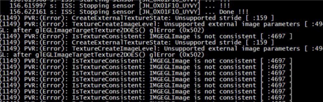

    EGLImageKHR appEglWindowCreateIMG(app_egl_obj_t *obj, app_egl_tex_prop_t *prop)
    RTOS SDK 8.5
    J721S2
    Crop_w:
    4 failed
    8 failed
    16 failed
    32 failed
    64 succeed
    800 failed
    768 succeed
    Here is the failed log:
    Zekun

    One limitation I am aware of is the need for 64-bit alignment for the memory. This might be the reason resolutions that are not multiples of 64 are not supported, the driver implementation will not do padding.

  • Hi, Erick
    Customer test on 8.0,  if not align with 64 bit, it will failed.
    But on SDK 8.4, if will succeed without alignment of 64 bits.
    GPU had a upgrade from 8.0 to 8.4, so is it related to GPU?
    Customer want to know if this need is mandatory or it is just for high performance. If for high performance, is there any way to avoid this requirement?
    Zekun
  • Zekun,
    This should not have been the case before as well, I'm surprised the behavior changed. The GPU driver version did change between those two releases (1.13 vs 1.15 DDK).
    As I understand, it is mandatory because going lower will be going smaller than the GPU cache line size, which can cause other issues in the driver. So please stick to using 64-bit alignment or higher.
