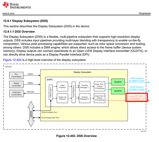

It seems AM62P supports BT656 in following TRM. (https://www.ti.com/lit/ug/spruj83/spruj83.pdf)
Could you check the 12.9.1.1 DSS Overview and confirm if AM62P supports BT6565.

We support BT656 with embedded syncs and not discrete syncs.
