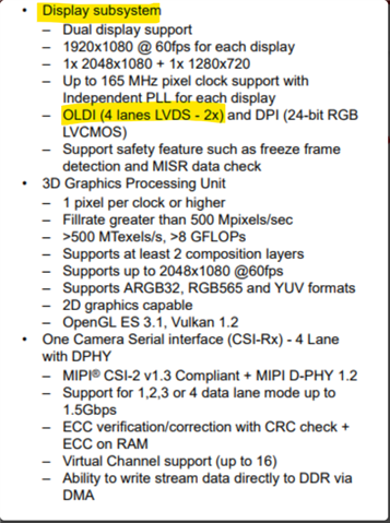

Hi Expert,
The customer's camera output is in LVDS format.
Can AM623 support lvds video input?
The customer originally used the "Video Input Port" of AM5728 to connect to CAMERA. Without changing the camera, is it feasible to replace AM5728 with AM623 or AM62A3?
