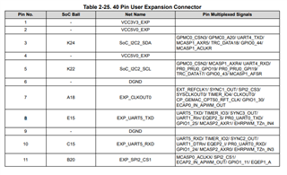

I'm trying to do a UART serial loopback through the AM625 PRU, however, it's not working as desired, even using the Texas examples. Basically, TX/RX doesn't work.
The version of Code Composer Studio is 12.6.0.00008
I'm using the firmware that comes directly from the Texas Intruments website: tisdk-default-image-am62xx-evm.wic. I didn't configure anything different in it, just using the default version.
Below is the code attached and a video of the unexpected situation. Thanks

#define TX_PR0_UART_PINMUX ( *( volatile uint32_t * )( 0x000F41DC ) )
#define RX_PR0_UART_PINMUX ( *( volatile uint32_t * )( 0x000F41D8 ) )

    // PINMUX configuration for UART_PRU TX/RX on 40 pins expansions header
    TX_PR0_UART_PINMUX &=~ 0b111;
    TX_PR0_UART_PINMUX |= 0b110;
    map_0  = TX_PR0_UART_PINMUX;
    RX_PR0_UART_PINMUX &=~ 0b111;
    RX_PR0_UART_PINMUX |= 0b110;
    map_1 = RX_PR0_UART_PINMUX;

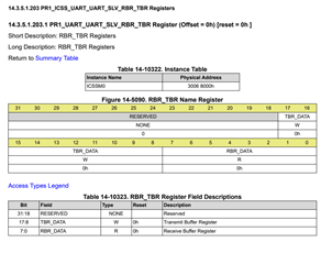

            CT_UART.RBR_TBR_bit.TBR_DATA = tx;

            rx = CT_UART.RBR_TBR_bit.RBR_DATA;

  • I did some tests and it seems that the same error persists, as it does not exit the reception waiting period. I recorded another video quickly demonstrating what happens.
    My TX/RX connection on the board is also attached as the image below. I've already tried changing the connections between all the possible alternatives encompassing the 4 pins around it, but still nothing. The registers show that the peripheral settings are correct.
    I used the following source to connect the pins:
  • Even without pinmux configuration, just the loop, hangs in the same part

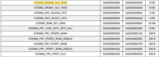

    I use the TRM to figure out that the ICSSM0_DRAM0_SLV_RAM is at 0x3004_0000
    Here is what I see when I inspect the .bss data region of the DRAM0. hostBuffer data (the TX data) is exactly where we expect:

    I'm still not seeing data coming in on the RBR_TBR register, which is concerning. It either means I'm not writing the data properly, or not reading the data properly...
    The AM62x TRM claims that the RBR_TBR register changed from AM335x to AM62x. What if the TRM is wrong, and the registers never changed?
    AM335x documentation:
    offset 0x0, write bits [7:0] to transmit, read bits [7:0] to receive
    AM62x documentation:
    offset 0x0, write bits [17:8] to transmit (already weird, 10 bytes instead of 8?), read bits [7:0] to receive
    When I change back to writing to bits [7:0], I am finally able to send and receive data.

    Also, another thing, shouldn't I be able to see the bits at 0x30068000, as per the table below? How did you know the specific range in DRAM0 that was equivalent to these 2. Because, from what I see, it covers a large area, as shown in the table below (8kb):

    MEMORY RBR/TBR TABLE (PRU UART REGISTER):
    RAM MEMORY RANGE:
    It would be great if you could answer these last questions of mine to have a better understanding of the application. I'm still kind of new to this direct memory access part.
  • Hello Rafael,
    Address for RBR and TBR?
    For PRU UART register information, please reference the AM335x TRM for now.
    I'm working with the rest of my team now to try to understand what the actual differences are between the AM335x & AM62x PRU UART register set are (if there are any), debug where errors crept into our register definitions in the TRM, and make sure we take all the steps to correct any misalignments between the HW docs and the actual circuitry within the processor.
    One thing you'll see in the AM335x TRM is that the RBR register and the TBR register are accessed at the same address. You get the TBR register if you perform a write, and you get the RBR register if you perform a read.
    Memory range
    That's what I was using the .map file for in my responses above. If we know that the variables are stored in .bss, and that .bss is getting stored in DRAM, then we can use the .map file to get the exact address offset for the data.
