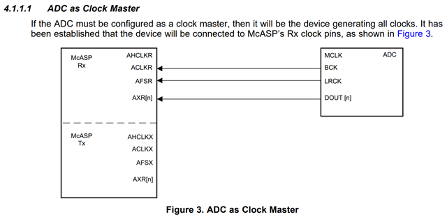

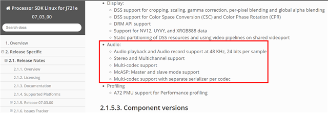

I have been testing J721e McASP(TDM) Master & Slave Mode,I am using J7 SDK 08.06.01.02 and McASP0 port. The McASP0 Master Mode is working fine.
But I have problems with McASP0 Slave Mode with J7.
In TI McASP Design Guide, if ADC is  configured as a clock master, the clock pins on ADC should connect to McASP’s Rx clock pins, as shown in following Figure.
Then I have modified DTS "k3-j721e-common-proc-board.dts" to configurate McASP0 (ACLKR & AFSR), and set MCASP0_ACLKR & MCASP0_AFSR as INPUT.
mcasp0_pins_default: mcasp0-pins-default {
	pinctrl-single,pins = <
		J721E_IOPAD(0x0B8, PIN_INPUT_PULLDOWN, 12) /* (AE27) PRG0_PRU0_GPO2.MCASP0_ACLKR */
		J721E_IOPAD(0x0BC, PIN_INPUT_PULLDOWN, 12) /* (AD26) PRG0_PRU0_GPO3.MCASP0_AFSR */
		/* J721E_IOPAD(0x0D4, PIN_OUTPUT_PULLDOWN, 12) /* (AB26) prg0_pru0_gpo9.MCASP0_ACLKX */
		/* J721E_IOPAD(0x0D8, PIN_OUTPUT_PULLDOWN, 12) /* (AB25) prg0_pru0_gpo10.MCASP0_AFSX */
		J721E_IOPAD(0x0B0, PIN_OUTPUT_PULLDOWN, 12) /* (AF28) prg0_pru0_gpo0.MCASP0_AXR0 */
		J721E_IOPAD(0x0B4, PIN_INPUT_PULLDOWN, 12) /* (AE28) prg0_pru0_gpo1.MCASP0_AXR1 */
But when I tried to record a raw file on McASP0 port with ALSA command:
arecord -Dplughw:0,1 -d 10 -r 48000 -f S16_LE -t raw /bin/RecordFile
I found MCASP0_ACLKR pin is wtill generating 6.14M colck, shouldn't it be in receiving mode?
