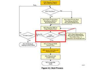

Currently they have a concern that if their Uboot image is not complete by mistake or due to some reasons, could we guarantee it could use the backup boot automatically or not?
We have studied the TRM about this part, and as you could see the below flow chart. There is a image integrity check, if this is passed, then it will continue using primary boot, if not, then the backup boot will be used.
The question is that could you provide some more details about the image integrity check here please
We need to know is it possible that the image integrity check is passed but actually the uboot image is not complete so that we might be stuck in the primary boot flow and could not reach to the uboot stage.
If this situation happens, what will be your suggestions to make it work?

    Integrity check validate the hash of the image with the hash present in the certificate.In case of GP device we make use of degenerate RSA keys to sign the image whereas in case of HS-SE device we use root trust keys.
    The integrity check will only pass if it matches with the hash present in the certificate.
