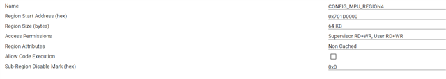

    The MPU REGIN setting was missing in sysconfig, so I added it.
    After modifying it as shown below, building and running it, IPC RPmessage was realized on NORTOS.
    thank you.

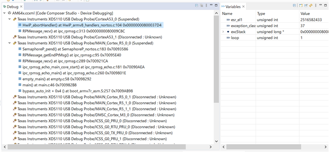

  • Hello Swargam Anil
    additional information.
    Processing was not completed even though gMsgEchoCount was 1000.
    When I suspended CA53 and CR5, it stopped at the following point.
    Is there any waiting time required inside the for loop?
    It seems to be working fine in step execution.
    Kiyomasa Imaizumi.
    Hello Kiyomasa Imaizumi,
    Thanks, one problem s solved: porting examples from RTOS to NO RTOS.
    The above comment on other issues is that your A53 core went into some handler state, and this should not have happened.

  • Hello Kiyomasa Imaizumi.
    I have looked at your code, and it seems OK but I found the issues in MMU settings in A53 core for IPC.
    You can directly take an IPC example of A53 core and add your changes in this example. This is good to approach instead of adding changes in empty project.
    After that, try examples at your side. If it still is not working, I can check at my side. And share your updated examples if the examples are not working after the MMU changes to A53.
