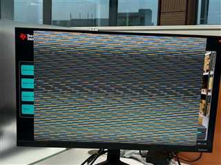

  • Hi Fabiana, Thanks for the help.
    I made the required change in /scripts/setup_cameras.sh and ran the camera open command which gave below output.
    Just to make sure my .bin files are correct I created it for 640x480 and replaced the already existing bin files. It worked fine. That made me convinced that I am creating bin files the correct way but it is working only for few predefined resolutions like 640x480 but not for resolutions like 800x1200.
    I think there are some more changes in settings required to work with custom resolution. Please help.
  • Hi Tarun,
    Could you share what camera open command you ran? What resolution is your display? Could you see if 1200x800 resolution is successful while I discuss with our imaging team? If 1200x800 is possible, you could rotate the image to get the desired view.
    Thank you,
    Fabiana
  • Camera open command:
    gst-launch-1.0 v4l2src device=/dev/video2 io-mode=5 ! queue leaky=2 ! \
    video/x-bayer, width=800, height=1200, framerate=30/1, format=rggb ! \
    tiovxisp sink_0::device=/dev/v4l-subdev2 sensor-name="SENSOR_SONY_IMX219_RPI" \
    dcc-isp-file=/opt/imaging/imx219/dcc_viss_800x1200.bin \
    sink_0::dcc-2a-file=/opt/imaging/imx219/dcc_2a_800x1200.bin format-msb=7 ! \
    tiovxmultiscaler ! \
    video/x-raw, format=NV12, width=800, height=1200, framerate=30/1 ! \
    kmssink driver-name=tidss sync=false
    NO , 1200x800 resolution was also not successful , I have tried it too.
  • Hi Tarun,
    If IMX219_CAM_FMT='[fmt:SRGGB8_1X8/800x1200]', could you try running this pipeline instead:
    video/x-raw, format=NV12, width=1920, height=1080, framerate=30/1 ! \
    The commands you are giving have output resolution as 1920x1080 , I want it such that the input and output resolution should be 800x1200.
    when i am running this command:
    its not giving any image just the image I showed .
    similar thing is happening when I am running this command :
    video/x-bayer, width=1200, height=800, framerate=30/1, format=rggb ! \
    dcc-isp-file=/opt/imaging/imx219/dcc_viss_1200x800.bin \
    sink_0::dcc-2a-file=/opt/imaging/imx219/dcc_2a_1200x800.bin format-msb=7 ! \
    video/x-raw, format=NV12, width=1200, height=800, framerate=30/1 ! \
    Please give me command or any other change that is required in settings or anything?
