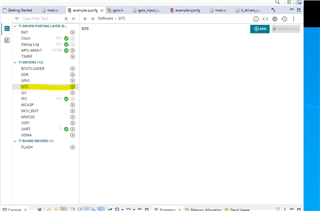

  • Hello Joseph ,
    There is a PMU timer that is available on R5F and you can use it for time stamp application applications, but again, this will not work properly in Free rtos applications.
    You can try the GTC timer, and it is available on the WAKEUP domain and just configure from system config and run this wakeup application on your soc.
    So, that your GTC is running continuously on WKUP domain . Now, for the MCU R5F application, just try to read the GTC counter values .
    S.Anil.

  • Hello Joseph,
    Please try the settings below in your MCU R5F application.
    As per TRM, the GTC is divided into 4 parts. GTC_CONFIG0 to GTC_CONFIG3 and each one is 4KB.
    So, WKUP GTC address should be changed to MCU R5F RAT Region.
    I have captured all the images related to the configuration below configuration. Please let me know if you need any questions.
    After making these changes, you need to a call below to API to read the content of the GTC timer.
    Now, BaseAddr has content of the GTC counter. Can you please confirm whether these settings work or not on your side ?
    S. Anil.
