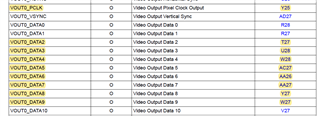

Hello TI experts,
Could the 2 LSBs be used as GPIO for other usage when BT.656 8bit mode is enabled?
According to TRM, Bits 9 to 0 are dedicated for BT.656 mode (10-bit). In BT.656 mode however, for compatibility with existing 8-bit interfaces, the two LSBs are ignored and only bits [9-2] are effectively used.
