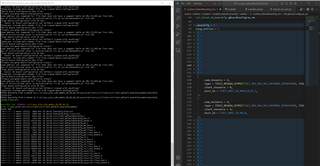

  • Hi Tushar,
    I test the ospi boot mode,
    modify the Resource Management Configuration Data,and rebuild,
    then rebuild SBL example, flash SOC,
    if use main domain GPIO, interrupt example can runing,
    but use mcu domain GPIO, still error.
    Allen

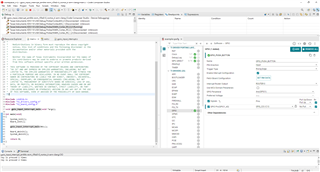

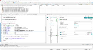

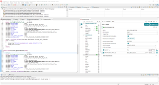

  • Hello Allen,
    Thanks for your patience.
    The MCU+SDK example are not made to support the cross functionality. Please refer release notes.
    You need to do the GPIO configuration changes in the example to make it work for MCU M4F.
    Please follow the below steps.
    • Please change the host_id of TISCI_DEV_MCU_MCU_GPIOMUX_INTROUTER0 in sciclient_defaultBoardCfg_rm.c file as below.
    • After doing the above change, please rebuild the board config by running below command.
    gmake -s -C tools/sysfw/boardcfg
    • Clean and Rebuild the SBL null binary by running below command
    gmake -s -C examples/drivers/boot/sbl_null/am64x-evm/r5fss0-0_nortos/ti-arm-clang clean
    • Initialize the EVM with the newly created SBL binaries. For info, please refer EVM_FLASH_SOC_INIT.
    • In the example.syscfg file, please do below changes.
    • Build the GPIO Input interrupt example.
    • Copy the files generated by sysconfig tool into the project as shown below.
    • Right click on the example.syscfg file and exclude this from build settings. Please refer below image.
    • Please change the BOARD_BUTTON_GPIO_INTR_NUM and dst_host_irq to CSLR_R5FSS0_CORE0_INTR_MCU_MCU_GPIOMUX_INTROUTER0_OUTP_3 in ti_drivers_config.c file.
    • Rebuild the project.
     After doing the above changes the GPIO Input interrupt example should work as expected. Please let me know if the above solution works.

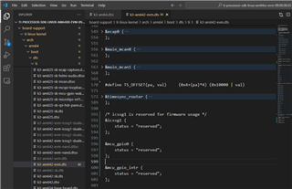

  • Hello Allen,
    Thanks for your response. Please find the below explanation.
    Root Cause of the Problem
    The GPIO_INPUT_INTERRUPT example running on R5FSS0_0 is based on MCU+ SDK while Linux running on A53 is based on Processor SDK. The problem comes because of the RM configuration differences in these SDKs. We have to initialize the board with the right RM configurations to make this example work.
    There are three ways to initialize the board:
    S. No. Boot Flow Use Case
    1 SBL from MCU+ SDK NORTOS/FreeRTOS example running on A53SS, R5FSS, M4FSS
    2 SPL from Processor SDK Linux running on A53SS
    3 Linux SBL from MCU+ SDK NORTOS/FreeRTOS example running on R5FSS, M4FSS & Linux running on A53SS
    The default GPIO_INPUT_INTERRUPT example is coded to work out-of-the box with the SBL from MCU+ SDK. If we used SPL to initialize the board, then the example does not work because Processor SDK uses different RM configurations. For the third option, the RM configurations used are the same as used in Processor SDK so the example does not work in this case also.
    In a nutshell, the GPIO_INPUT_INTERRUPT example works only with the first option while we need to tweak the RM configurations in case of second and third option to make the example work.
    Modifying the Resource Allocation
    To run the default GPIO example with Linux SPL, you need to modify the resource allocation for MAIN_GPIOMUX_INTROUTER & MCU_GPIOMUX_INTROUTER to route interrupts to R5F core instead of A53.
    For more details on GPIO interrupt router, please refer GPIO Interrupt Router.
    Please change the rm-cfg.yaml file located at path ${Processor SDK}/board-support/ti-u-boot/board/ti/am64x/ as given below.
