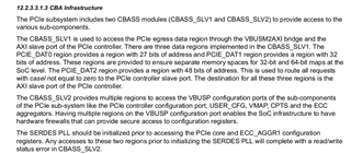

    dma_alloc_coherent returns address range for which memory attributes are already set, so cache is handled automatically, however, MSMC L3 cache handles snooping for cache on our system. kzmalloc requires extra cache clean and invalidate in a normal system, but this is handled by MSMC.
    Additionally, if outbound transactions are being done, the memory address needs to get translated to PCIe address. This translation is automatically done by iATU on TI SOC when writes are done to PCIEX_DATX region.

  • Hi Qiang,
    For PCIe there needs to be a translation between VBUSM to AXI between device and PCIe controller. This bridge is accessed through accessing the PCIEX_DAT0, and DAT1/DAT2 regions. Reference below taken from TRM:
    TRM also describes difference between inbound and outbound translation mechanisms, as there is difference between PCIe address to AXI address translation vs VBUSM to PCIe address translation.
    Takuma

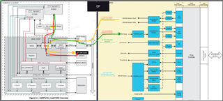

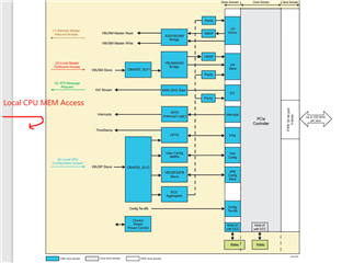

    Thank you very much for patiently answering my question. Based on your suggestions, I found that there is no Local CPU Mem Access data flow in the PCIe subsystem, as shown in the diagram below. Can I assume that the latency of CPU accessing the EP-side BAR is not introduced by the PCIe subsystem?
    Qiang
  • Hi Qiang,
    In practice, I think it is safe to say that read/writes to BAR address spaces imply communication between PCIe devices. Therefore, when local CPU accesses BAR space, it would only be for the purpose of communicating between PCIe devices.
    In our system, writes from local CPU will go through the VBUSM2AXI bridge, and transactions from a remote device will go through the AXI2VBUSM bridge as shown in the block diagram you have shared, which will be different from a normal CPU read/write to local memory that is not related to PCIe or other peripherals.
    Takuma
  • Hi Takuma,
    I've consulted the manual, and I understand your point. Typically, accessing PCIe devices follows the green path, through the VBUSM2AXI bridge, then accessing the remote device. Then, the remote device accesses its local BAR via the yellow path. However, my question is, when the CPU on the EP side accesses its own BAR, does it follow the red path? Is it similar to accessing regular memory?
    Qiang

  • Hi Qiang,
    I reviewed the diagram and arrows, and your understanding is the same as my understanding for yellow and green paths.
    However, BAR is only accessed for inbound address translation while iATU is used for all outbound translations, so there are no cases where local EP accesses its own BAR space. For example, local writes to DAT0 or DAT1 will go through the iATU path (green path) while writes from external device goes through the BAR0-7 path (yellow path).
    Takuma
  • Hi Takuma,
    Yes, I agree with your statement. Normally, the PCIe BAR is only used for inbound address translation. However, on our Endpoint (EP) side, there's a local CPU, and the EP's BAR is emulated through the EP side's memory space. So, the CPU only needs to know the memory address corresponding to this EP BAR to access the memory corresponding to the BAR via the red path, indirectly accessing the BAR space of the EP. I've conducted experiments and indeed, it's the case. However, the access speed has consistently been very slow, and it's unclear why. It's just as mentioned before, accessing the simulated EP BAR memory is significantly slower than accessing other memory.
    Qiang
