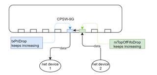

Hello, We encountered a packet loss problem when using CPSW-9G as a switch, here is the network topology of our project:
net device 2 sends data to net device 1 via CPSW-9G, and we found occasional packet loss in this chain. here is the log output of CPSW-9G printed by function "EnetAppUtils_printMacPortStats9G" after running for some time:

    Yes I understand this. All the Rx and Tx statatistics are from the perspective of the switch.
    What I mean above is that in our case packages from SOC, i.e. rxGoodFrames of Host Port, are also transmitted to external Port-2. And rxGoodFrames of Host Port is mcuh larger than that of external Port-5.
    As you mentioned, Host Port is much faster than external ports. So I don't understand why the txPriDrop of Port-2 only causes rxTopOfFifoDrop on Port-5, buf not on Host Port.
    BTW, what's the theoretical bandwidth for Host Port, on both Tx and Rx direction?
    Mian
    In your test, the data is from port-5 to port-2 between net device-1 & net device-2.
    So, while forwarding the ingress data from port-5 to egress on port-2 above is happend due to SOF might be overwritten by ingreds data on port-5 before egress on port-2.
    Also, as you mentioned Host port data also egress on port-2, which could also reason for fifo overflow at port-2.
    But, may be host port forwarding data may not be lost so, we may not observed any drop in that path.
    Sudheer

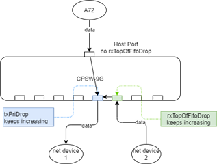

    I'm sorry but the topology schema above is not a complete one. Please refer to the picture below.
    Frames ingressed on Host Port and Port-5 engress on Port-2 at the same time. And the data amount ingressed on Host Pot is larger than on Port-5.
    However, the number of txPriDrop on Port-2 is identical to rxTopOfFifoDrop on Port-5. And from the log, there is no rxTopOfFifoDrop on Host Port. So I wonder why when Host Post has larger data amount and faster operation.
    Mian
    I understood from above statistics log, Host Port also sending traffic on Port-2.
    In this case we have seen only the packet coming from Port-5 to Port-2 only overflowed, from statistics.
    Let me check with expert/IP team/, why Host Port data is not overflown at Port-2.

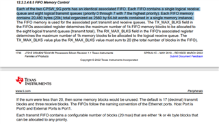

    I have some more questions concerning FIFO of CPSW9G. I'll use datasheet of TDA4VM below as an example.
    First in datasheet, I can see description concerning FIFO in section 12.2.2.4.6.5 as in pciture below.
    What does it mean by Each of the two CPSW_9G ports?  Does it mean two ports share one common FIFO? Or does it mean there is a FIFO of 20K size between every two ports? And does this description apply to Host Port as well?
    Then, I see another decription concerning FIFO in secition 12.2.2.4.6.10.11 as below.
    Here it says all ports have a FIFO of 80K in size. I'm a little confused. What's the difference between FIFOs decribed in these two sections? Are they the same thing? Similarly, does this section goes for Host Port, too?
    Besides, I also wonder what's the bandwidth of the Host Port. As I know we can set the speed of external ports to 10M, 100M or 1000M. Can we do the same for Host Port?
    Looking forward to your reply.
    Best Regards.
    Mian
    Each Port has 20KB FIFO which is divided into 8 Tx Queues (for Priority0 to Prioriry7) and 1 Rx Queue.
    Size of each Tx Queue will be 2K default, and Rx will use 4K.
    Which is same in case of Host Port also. There might  be some typos in TRM.
    The Link speed are 10M, 100M, 1000M where the External Port FIFOs will be empty at the link speed rate.
    Host Port is internal to CPSW, Speed will not applicable for that.

    Above rxTopOfFifoDrop is because of following flow in forwarding the packets from one Port ingress to other port egress.
    in Ethernet port ingress, packets will be either:
    (A) forwarded if there is space in the destination port's FIFO,
    or
    (B) dropped if no space on destination port's FIFO (rxTopOfFifoDrop) and on destination port it will increment the TxPriDrop based on packet priority.
    And the same above can't be seen in Host port ingress, because packets forward will be either:
    or
    (B) host port ingress will be halted if destination port's FIFO is full (here Host Port ingress is halted, RX fifo gets full condition and doesn't fetch new descriptors).
    Sudheer
