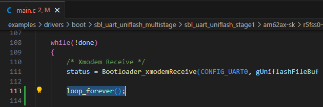

    1) Inject an infinite loop like shown below. This will make Stage1 receive the Stage2 image over UART but then gets stuck in the infinite loop.
    2) Built the SDK in debug mode.
    gmake -sj4 PROFILE=debug all
    3) Change the word 'release' to 'debug' in the .cfg file to point to the debug images.
    4) Perform the flashing procedure.
    5) Once the Python Uniflash script finishes, connect to the EVM using CCS.
    6) Connect to the WKUP R5F core.
    7) Load the Uniflash Stage1 symbols using:
    Run -> Load -> Load Symbols... -> Browse -> <MCU_PLUS_SDK_PATH>/examples/drivers/boot/sbl_uart_uniflash_multistage/sbl_uart_uniflash_stage1/am62ax-sk/r5fss0-0_nortos/ti-arm-clang/sbl_uart_uniflash_stage1.debug.out
    8) Make the loop variable equal to 0 using the Variables view (View -> Variables)
    9) Step into the code & note the first point when the status becomes failure.
    Prashant
    What I did:
    Inside SDK path:
    1. Edited examples/drivers/boot/sbl_uart_uniflash_multistage/sbl_uart_uniflash_stage1/am62ax-sk/r5fss0-0_nortos/main.c ( added loop_forever)
    2. make -sj4 PROFILE=debug all
    2. cd tools/boot
    3. Edit sbl_prebuilt/am62ax-sk/default_sbl_null_hs_fs.cfg
    in 4 files changed release to debug
    4. Flash with command: python3 uart_uniflash.py -p /dev/ttyUSB0 --cfg=sbl_prebuilt/am62ax-sk/default_sbl_null_hs_fs.cfg
    The flash process failed with stage 2 reaching 99%
    "Sending ../../examples/drivers/boot/sbl_uart_uniflash_multistage/sbl_uart_uniflash_stage2/am62ax-sk/r5fss0-0_nortos/ti-arm-clang/sbl_uart_uniflash_stage2.debug.appimage.hs_fs: 155396bytes [00:16, 10717.40bytes/s]error_count reached 16, aborting.
    [ERROR] XMODEM recv failed, no response OR incorrect response from EVM OR cancelled by user, "

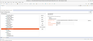

    The TI AM62A board already has one XDS110 debugger on-board. It can be directly used with CCS to debug any core.
    I haven't tried to work with XDS110 debugger before. I located some PDF under ccs1260/ccs/ccs_base/common/uscif/xds110/XDS110SupportReadMe.pdf
    So I tried to run from ccs1260/ccs/ccs_base/common/uscif/xds110
    ./xdsdfu -e
    USB Device Firmware Upgrade Utility
    Copyright (c) 2008-2019 Texas Instruments Incorporated. All rights reserved.
    Scanning USB buses for supported XDS110 devices...
    Found 0 devices.
    ./xds110reset
    ERROR: Failed to connect to XDS110 (-260).
    Check USB connection to the XDS110.
    The board is "UART BOOT MODE", powered ON and the serial cable connected to PC.
    What am I missing?
    Please advice

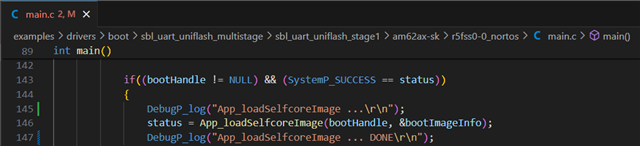

    So, the idea is we simply add a bunch of debug statements and see which one is not printing. I highly suspect the Stage1 fails in App_loadSelfcoreImage so we can probably add something like
    After adding a bunch of print statements, please add the UART logging also in the Uniflash Stage1 Sysconfig (make sure the settings in red boxes matches)
    Then,
    - Open all the UART ports corresponding to the board except the one used with `uart_uniflash.py`.
    - Perform the flashing procedure.
    - You should be seeing the debug statements on one of the UART.
    Prashant
    I'm with you and do what ever you say)
    I opened sysconfig and managed to configure the "Debug log" tab as in your picture
    But in other tabs looks like you configured some other stuff too. Do I need to configure those too? ( for example in MPU ARMv7 you have 14/16 and I have only 1)
    I'm a bit confused about the rest of the procedure after I changed UART in sysconfig.
    I saved the configuration and what I should do now? Do I need to load/ activate it somehow?
    In CCS open other 3 /dev/ttyUSB1,2,3 terminals?

    Yes, this looks good and the changes as well. Rebuild and perform the flashing procedure.
    I hope you have removed the loop_forever previously suggested to debug with CCS.
    A small update.
    I don't know how or why, but ..
    With sysconfig opened, main.c file changed (added 2 debug prints ), recompiling the SDK with "make -sj4 PROFILE=debug all" I managed to pass all 4 stages in flash process with the command:
    What should I try next?

  • Well,
    I did change main.c
    Recompiled SDK
    Rebooted board
    Pressed RESTART button in sysconfig
    Command "python3 uart_uniflash.py -p /dev/ttyUSB0 --cfg=sbl_prebuilt/am62ax-sk/default_sbl_null_hs_fs.cfg" failed on stage 2
  • Hi Daniel,
    This is very weird. I am curious to find out why simply adding those changes results in the successful flashing procedure. Good thing is I believe with those changes you are at least unblocked now and so can continue with your development activities.
    But I really would like to find out the root cause of the flashing failure with the unchanged images. If you are interested, we can work together to find the root cause.

    I think we need the CCS here to see what is going on.
    If you have done the CCS setup, can you please connect to the WKUP R5F core after the failed flashing procedure and note down the address at which the core is suspended.
    If the address looks something like 0x43xxxxxx then we are definitely in the Uniflash Stage1 then by loading the Symbols you can also see where the control is actually in the code.
    Prashant
    Can you please guide me please how to connect to the WKUP R5F?
