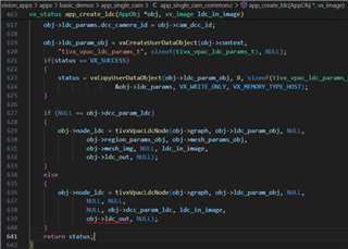

  • Hi I modify the grapsh parameters like below But it showed  the error.
    VX_ZONE_ERROR:[vxSetGraphScheduleConfig:188] Invalid parameters
        /* input @ node index 1, becomes graph parameter 0 */
        add_graph_parameter_by_node_index(this->obj->graph, this->obj->capture_node, 1);
    /* set graph schedule config such that graph parameter @ index 0 is enqueuable */
    graph_parameters_queue_params_list[graph_parameter_num].graph_parameter_index = graph_parameter_num;
    graph_parameters_queue_params_list[graph_parameter_num].refs_list_size = this->obj->num_cap_buf;
    graph_parameters_queue_params_list[graph_parameter_num].refs_list = (vx_reference*)&(this->obj->cap_frames[0]);
    graph_parameter_num++;
    add_graph_parameter_by_node_index(this->obj->graph, this->obj->node_ldc, 7);
    graph_parameters_queue_params_list[graph_parameter_num].refs_list_size = obj->table_width * obj->table_height;
    graph_parameters_queue_params_list[graph_parameter_num].refs_list = (vx_reference*)&(this->obj->ldc_out);

  • No, the type of ldc_out is vx_image.
    It is defined as follows from app_single_cam_common.h.
    I am also curious about the difference between the display node and the ldc node.
    The following code snippet is from
    app_single_cam. The display node can use vx_image directly.
    P.S.: I tried setting
    refs_list_size to 1 for the ldc node, but it still doesn't work.

    In app_single_cam_common.c, ldc_out is the 7th parameter of the ldc node.
    I believe this is correct; I also checked the
    app_multi_cam_codec example.
    They use the same index at
    main.c::1272.
    add_graph_parameter_by_node_index(obj->capture_graph, obj->ldcObj.node, 7);
                    obj->ldcObj.graph_parameter_index = capt_graph_parameter_index;
                    obj->enc_pool.graph_parameter_index = capt_graph_parameter_index;
                    capt_graph_parameters_queue_params_list[capt_graph_parameter_index].graph_parameter_index = capt_graph_parameter_index;
                    capt_graph_parameters_queue_params_list[capt_graph_parameter_index].refs_list_size = obj->enc_pool.bufq_depth;
                    capt_graph_parameters_queue_params_list[capt_graph_parameter_index].refs_list = (vx_reference*)&obj->enc_pool.arr[0];
                    capt_graph_parameter_index++;
    But in case of display, this is a test_mode and it will just work with the single image. As you can see in below statement, it just enqueues a single image and never dequeues or changes the images.
    status = vxGraphParameterEnqueueReadyRef(obj->graph, 1, (vx_reference*)&(obj->display_image), 1);
    If you want to use the output as graph parameters, so that you can get the access to the LDC output image, you need to create an array images, like the capture output, and do the enqueue and dequeue operations, to allow pipeline working.
