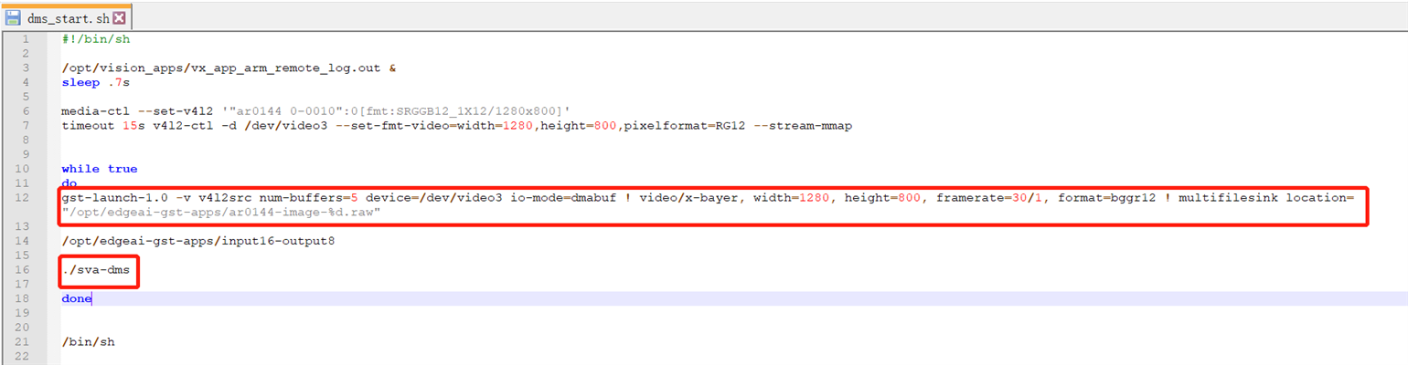

I'm using sdk9.1 and I'm debugging a DMS project. You need to save the image to a certain path of EMMC, and then use the algorithm SDK to identify the state of distraction or fatigue.
But I ran into some trouble, and I didn't know how to set the two actions of camera image storage and algorithm processing to start automatically when booted.
I tried putting them together with a shell script but it didn't work. Because they are all in the loop, executing one of them, and the other can only wait and wait, unable to proceed.
Here's how I did it:
1. Script content:
2. Copy dms_start.sh to the /etc/init.d directory
