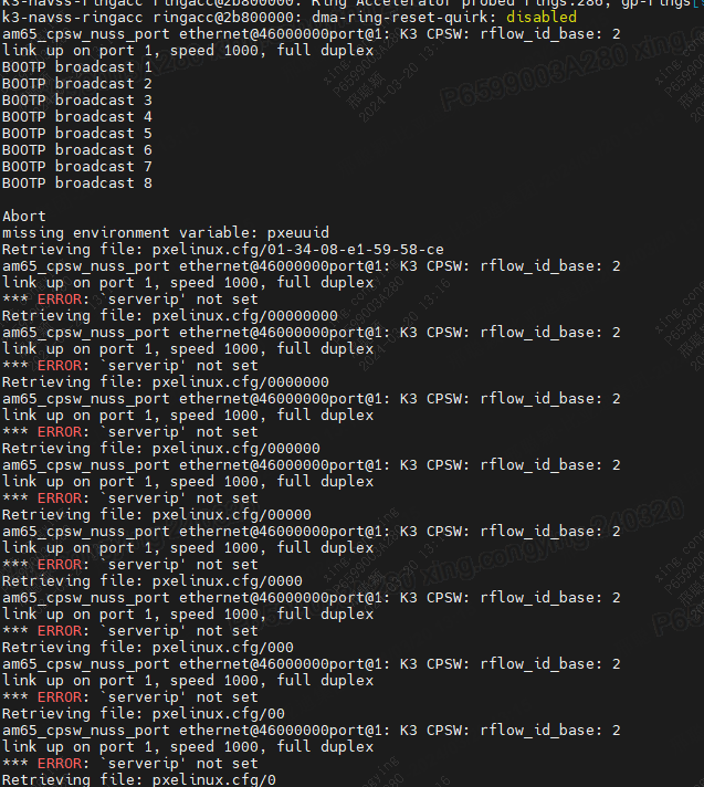

a、The serializer address is assigned to the serializer in turn according to the addresses 4a~4f that can be assigned in the deserializer device tree, and all of them fail to be identified, but the development board can be started
b、If you change the Sensor I2C address to the 0x21 given by the manufacturer, the development board will not even start, and an error will be reported after it is stuck
c、We also found in the forum that the imx390_serdes_config.h file defines rcm/cm and the corresponding address, etc., and we also tried to change the I2C address corresponding to rcm in the file to 0x21, but it cannot be started, and an error is reported after getting stuck. In short, we found that as long as the default 0x1a address of the camera is changed, the development board will definitely fail to boot and an error will be reported

    But the ds90ub954 and imx390 never can be probed due to :
    We want to know if there is an address conflict? or is there a problem with the way to decompile the device tree?
