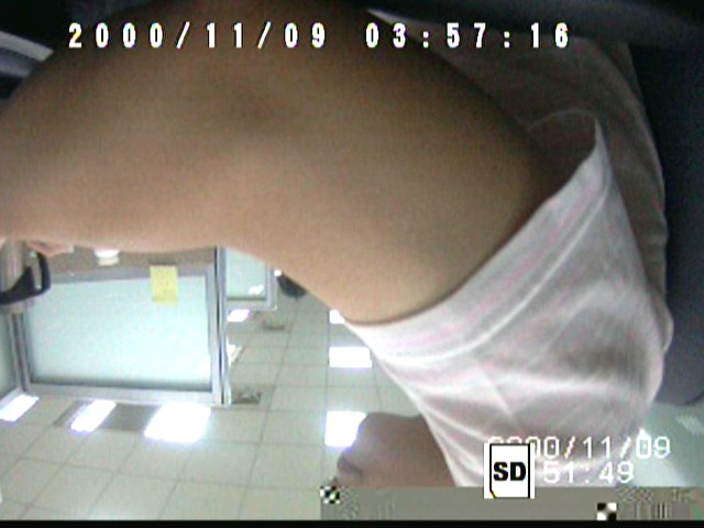

I encounter two issue about decode MJPEG
1.
   the image as below ( Note the lower right corner of the image)
This phenomenon not always appear. so That's strange
I don't know what's wrong?
I think the only adjustment of ALG_VidDecRunPrm in ALG_vidDecRun
my code is following:
        whOffset = 0;
        runPrm.inAddr         = inAddr;
        runPrm.outAddr        = gDECODE_ctrl.decBufVirtAddr[gDECODE_ctrl.curDecBufId];
        runPrm.inDataSize     = inDataSize;
        runPrm.outOffsetH     = OSA_align(frame->width+whOffset, 32);
        runPrm.outOffsetV     = frame->height+whOffset;
        runPrm.inputBufId     = gDECODE_ctrl.curDecBufId;
Does whOffset need to change?Is it has proper value?
Or anyone can give me other suggestion?
2.
Other question about create MJPEG encoder parameters.
I found qValue it has the greate impact for decoder.
It occur decode fail or Alignment trap during try and error.
I has four resolution used ( 320x256 .  800x480 . 1280x736 . 1920x1088 )
Is qValue has the recommanded value or the equation to calculate?
