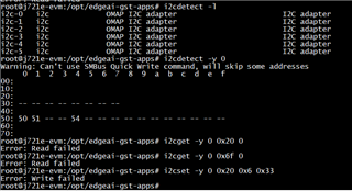

Hello Champs,
Customer is using is Processor SDK Linux for TDA4VM 09_01_00.
Configure by referencing [FAQ] [FAQ] CCS/TDA4VM/J721e/J7200: How to enable RTC on Jacinto TDA4x EVM? - Processors forum - Processors - TI E2E support forums
Check /dev/rtc* after power down, only /dev/rtc and /dev/rtc0, via dmesg | grep rtc.
[1.761701] tps6594-rtc tps6594-rtc.4.auto: Registered as rtc0
[1.767663] tps6594-rtc tps6594-rtc.4.auto: hctosys: Unable to read the hardware clock
No RTC is shown for ds1307 (mcp79410).
What else need to configure in addition to the configuration in the above post? How to confirm that the MCP79410 is working?
