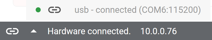

I have connected to the device through serial USB, it says connected and shows the device IP in the Model Composer Capture page footer.

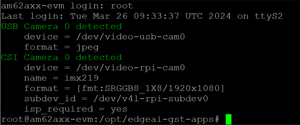

The device has an ArduCam 8mp (imx219) camera connected, which works perfectly well with the model examples bundled with the SDK.
I have SSH connectivity with the device.
My PC is on the same subnet as the device.

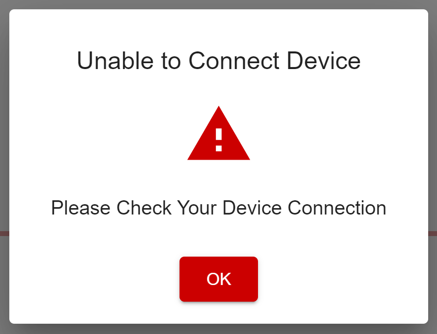

But when I select Device Camera as Input Source I only get a popup dialog that says "Unable to Connect Device. Please Check Your Device Connection".
Any idea on why it won't connect? Are there some specific ports that need to be open on the device? Does it only work for USB cameras?

  • Hello Magnus,
    It is our pleasure to help.
    The current version of the ModelComposer supports only USB cameras on the target for data collection and preview. After the model is compiled and downloaded to the target, CSI cameras can be used with the edgeai-gst-apps.

    Unfortunately I get the same error with an USB camera on the target AM62A. So I am currently unable to use the target AM62A for data acquisition.
