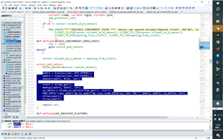

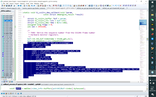

        The code for the new time-consuming test of the kernel driver is as follows:
        1.[ 108.097452] j721e-csi2rx 30102000.ticsi2rx: memcpy len 3932160 from addr 0x11e01000 cost time 39699 us, sequence: 12, idx: 1.
        2.[ 103.366459] <DRV_ADS6311> [1970-01-01 00:01:50 000.705.930] <I> 4152 copy addr1 00000000bab3f124 to addr2 00000000ae7456e2 cost time 5669 us, len: 393216 0.
