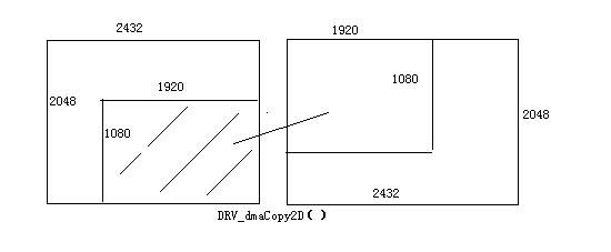

            Using IPNC 2.0, I have meet a problem of DRV_dmaCopy2D(). BTY, the data is YUV420.
        I want use DRV_dmaCopy2D() to do the copy of data. just like this:
Uint8 *srcPhysAddr, *dstPhysAddr; DRV_DmaCopy2D copy2D;
srcPhysAddr = (Uint8*)DRV_dmaGetPhysAddr((unsigned long)srcVirtAddr);
dstPhysAddr = (Uint8*)DRV_dmaGetPhysAddr((unsigned long)dstVirtAddr);
if(srcPhysAddr==NULL||dstPhysAddr==NULL)
return -1;
 copy2D.srcPhysAddr = (unsigned long)srcPhysAddr +(2432-1920);
copy2D.dstPhysAddr = (unsigned long)dstPhysAddr;
 copy2D.copyWidth = 1920;
 copy2D.copyHeight = 1080 * 3 /2;
 copy2D.srcOffsetH = 2048 - 1080;
copy2D.dstOffsetH =
2048 - 1080 ;
copy2D.skipH = 0;
DRV_dmaCopy2D(&dmaHndl, &copy2D, 1);
 Using the above code, the result is not correct. Anybody can help me?
And if I want to copy  any AOI of src, how to do? Thanks a lot!

  • since have no 2D EDMA copy way, I write a function to relize this function using memcpy.
    /*YUV420  AOI copy
      @src image source, YUV420 format
      @imgw image source width
      @imgh image source height
      @dest  dest image source, YUV420 format
      @aoix start x position
      @aoiy start y position
      @aoiw copy image width
      @aoih copy image height
      @attention the size of image source is imgw * imgh * 3 / 2
    int YUV420_AOI_Copy(char *src, int  imgw, int imgh,
                char *dest, int aoix, int aoiy, int aoiw, int aoih )
            int k = 0;
            if((aoix + aoiw > imgw) || (aoiy + aoih) > imgh)
                    return -1;
            char *ptrsrc = src + (imgw * aoiy) + aoix;
            for(k = 0; k < aoih; k++)        //copy Y data
                    memcpy(dest + k * aoiw, ptrsrc + k * imgw, aoiw);
            ptrsrc = src + imgw * imgh + (imgw * aoiy / 2) + aoix/2*2; //local to UV data
            char *ptrdest = dest + aoiw * aoih;
            for(k = 0; k < aoih/2; k++)
                    memcpy(ptrdest + k * aoiw, ptrsrc + k * imgw, aoiw);
    It is maybe help for you!
