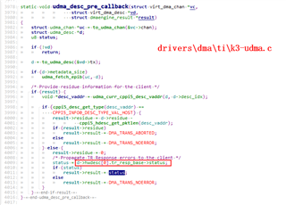

SK-AM62A-LP: Frame drop often happens on Am62ax platform?
Part Number: SK-AM62A-LP
  We are porting our dToF sensor from rockchip rk3568 to TI Am62ax SoC recently. Our dToF sensor output 4 streams (2 VCs and 2 data type: raw12 and raw8), and the first 2 bytes of the frame buffer for last streams(stream2, stream3) is frame id (16 bits value from 0 to 65535). Because from our test, it looks some frames are dropped, so I added the following code the check the continuity of the frame id,from the attached log, some frame-drop are happening.

Would you please help to check the reason and figure out a solution?
I have some ideas/questions, please help to check whether it help too?
1. Currently, the mipi link frequency is 500M, since the mipi frequency of the TX side of our dToF sensor is 1G. Can I increase the mipi link frequency of RX side from 500M to 600 or higher? Will this help the frame-drop issue?
2. Can we change the DMA buffer speed? If yes, how to do?
3. I will try to add the buffer count when the application call VIDIOC_REQBUFS ioctl commands.
------------------log-------------------------------
[ 513.722678] Failed DMA transfer retval=3, residue=0
[2022-05-04 00:01:44.305.475.100] ERROR: <v4l2_dev.cpp-usrExtFrameIdMatchCheck() 447> --last_frameId_in_raw: 2181, curFrameId: 2206 for stream2--...
[ 513.782685] j721e-csi2rx 30102000.ticsi2rx: DMA transfer timed out for drain buffer
[2022-05-04 00:01:44.367.935.735] ERROR: <v4l2_dev.cpp-usrExtFrameIdMatchCheck() 447> --last_frameId_in_raw: 2181, curFrameId: 2206 for stream3--...
[ 513.846682] j721e-csi2rx 30102000.ticsi2rx: DMA transfer timed out for drain buffer
[ 513.854670] Failed DMA transfer retval=3, residue=0
[ 513.859802] Failed DMA transfer retval=3, residue=0
[2022-05-04 00:01:44.442.392.015] ERROR: <v4l2_dev.cpp-usrExtFrameIdMatchCheck() 447> --last_frameId_in_raw: 2206, curFrameId: 2233 for stream2--...
[2022-05-04 00:01:44.442.670.220] ERROR: <v4l2_dev.cpp-usrExtFrameIdMatchCheck() 447> --last_frameId_in_raw: 2206, curFrameId: 2233 for stream3--...

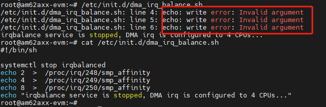

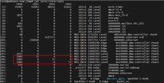

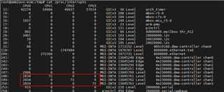

  • Here is intterrupts BEFORE and AFTER running our application, please see the attched log.

    root@am62axx-evm:/run/media/BOOT-mmcblk1p1/4G_new# echo 0x8 > /sys/kernel/debug/adaps/dbg_ctrl

    root@am62axx-evm:/run/media/BOOT-mmcblk1p1/4G_new# cat /proc/interrupts
               CPU0       CPU1       CPU2       CPU3
     11:       4729       5676       4506       5536     GICv3  30 Level     arch_timer
     14:          6          0          0          0     GICv3 108 Level     mbox-r5-0
     15:          6          0          0          0     GICv3 109 Level     mbox-c7x-0
     16:         31          0          0          0     GICv3 140 Level     mbox-mcu_r5-0
     17:          0          0          0          0     GICv3  23 Level     arm-pmu
     18:          0          0          0          0     GICv3 131 Level     pinctrl
     19:       3704          0          0          0     GICv3  66 Level     4d000000.mailbox thr_012
     28:       3459          0          0          0     GICv3 193 Level     20000000.i2c
     29:         10          0          0          0     GICv3 194 Level     20010000.i2c
     30:          0          0          0          0     GICv3 195 Level     20020000.i2c
    119:          1          0          0          0  MSI-INTA 1970707 Level     8000000.ethernet-tx0
    209:          1          0          0          0  MSI-INTA 1971731 Level     8000000.ethernet
    247:       1002          0          0          0  MSI-INTA 13045760 Level
    248:       1009          0          0          0  MSI-INTA 13045761 Level
    249:       1008          0          0          0  MSI-INTA 13045762 Level
    250:       1008          0          0          0  MSI-INTA 13045763 Level
    253:       3773          0          0          0     GICv3 210 Level     2800000.serial
    254:          0          0          0          0   pinctrl 456 Edge      2800000.serial:wakeup
    256:          0          0          0          0     GICv3 134 Level     8000000.ethernet

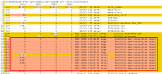

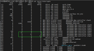

  • Hi Yogesh,
       I viewed the /proc/intterupts and /proc/meminfo before I run my application and during running my application. It looks all DMA intterupt happened on CPU0, please check the details as blow:
    Thanks and Best Regards,
    David
    ---------------------DURING running my application-------------------------

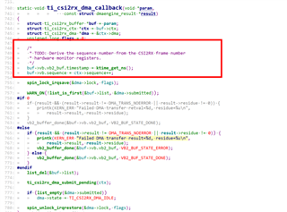

  • Hi Yogesh,
       I noticed there are some comments in drivers\media\platform\ti\j721e-csi2rx\j721e-csi2rx.c as below, would you please help to check whether you have implement the function to get frame id from mipi csi packet?
    David
  • David,
    No, getting frame id from mipi csi packets has not been implememted.

  • Hi David,
    This is not implemented in the driver, as this is done in cadence csi2rx IP for a single virtual channel at a time, so the multi-channel usecase of driver cannot use the counter for each virtual channel. Same was discussed in the upstream linux mailing lists when adding that TODO.
    You can follow Section 12.6.4.8.10 Stream Monitor Frame Capture Control in AM62A TRM, to program and read the frame monitor register in the cdns-csi2rx.c driver for Stream0 (which is routed to TI DMA)
    Optionally software can read back the frame count value from register
    (CSI_RX_IF_VBUS2APB_STREAM0_FCC_CTRL - CSI_RX_IF_VBUS2APB_STREAM3_FCC_CTRL).

  • Hi Jai,
       I noticed this status is 0x33 or 0x05 when a DMA error happens, would you please tell me which register I should refer to for this error, what they mean when it is 0x33 or 0x05.
    David

  • Seems this IRQ is tied to CPU0 and cannot be changed.
    Hi Yogesh,
        Really?  But I used the following command, it seems work? Please help to double confirm? And tell us how to implement IRQ balance with code or script instead of manual input commands.
    systemctl stop irqbalanced
    echo 2 > /proc/irq/248/smp_affinity
    echo 4 > /proc/irq/249/smp_affinity
    echo 8 > /proc/irq/250/smp_affinity
    then I cat /proc/intterupts, I can see some intterupts are handled by CPU1-CPU3.
    David
  • Hi David,
    These are DMA TR response errors. Please note the errors are in decimal, i.e. 33 and 5 which in hex is 0x21 (CBA error) and 0x5 (Short packet)
    You can refer to the TRM section "11.1.3.4 Transfer Response Record" for the detailed meaning.
    These errors are seen when sensor is streaming over CSI but the DMA was starved of empty buffers. When finally an empty buffer is pushed to DMA for filling, we see short packet or CBA bus error as due to starvation the StartOfFrame/EndOfFrame signals were missed so only partial data is copied over.
    My suspicion is the application is taking too much time to process frame data, and thus not queuing empty buffers (using VIDIOC_QBUF/VIDIOC_DQBUF) within the sensor framerate limit. This will lead to buffer pool becoming empty, stalling DMA and causing starvation.
    This will also explain why you were seeing multiple DMA drain/restart_dma() logs before the patch was shared to disable the logs, as CSI driver will try to drain its internal FIFOs when starvation happens to clear out old stale data.
    Can you profile how long the application is taking to process each frame - i.e. time between dqbuf and qbuf ioctls?

  • Hi Yogesh,
       Thanks for your suggestion.  I tried to implement a function as below, then I call it in my .s_stream callback function.
    static void set_dma_irq_balance(void)
    int dma_irq = 248;
    unsigned int cpu = 1;
    irq_set_affinity_hint(dma_irq,get_cpu_mask(cpu));
    irq_set_affinity_hint(dma_irq+1,get_cpu_mask(cpu+1));
    irq_set_affinity_hint(dma_irq+2,get_cpu_mask(cpu+2));
    I have 2 new questions:
    1. As you see, I hard-code the dma_irq in set_dma_irq_balance(), it may be not so good. Is there any API function to get the DMA's IRQ number? This IRQ number must be 247,248,249,250?
    2. I tested it with my modified driver. It seems work at the begin, there are some IRQ handled by CPU1-CPU3 as below photo.
      But after a while, when I cat /proc/interrupts once more, it seems all IRQ are changed back to CPU0, please see the following photo.
    Please help check them.

  • I tried to the following steps, but it doesn't work.
    // step 1
    root@am62axx-evm:/etc/init.d# cat dma_irq_balance.sh
    #!/bin/sh
    echo "irqbalance service is stopped, DMA irq is configured to 4 CPUs..."
    // step 2
    root@am62axx-evm:/lib/systemd/system# cat dma_irq_balance.service
    [Unit]
    Description=dma irqbalance daemon
    ConditionCPUs=>1
    [Service]
    ExecStart=/etc/init.d/dma_irq_balance.sh
    [Install]
    WantedBy=multi-user.target
    // step 3
    ln -s /lib/systemd/system/dma_irq_balance.service dma_irq_balance.service
    chmod +x /etc/init.d/dma_irq_balance.sh
    // manually execute the script
    system will output the following error
  • Hi Yogesh,
       It seems irqbalance is configured correctly, so that it bring some reverse action (DMA irq is focused on CPU0), would you please help to modify its configure , or add some code in ti_udma.c to balance the DMA irq?
    David

    However, if you make them into a script, and when you run the script it will have the below error right?

  • Yes, It is.  But it is best if you can help to tell us the correct configure for IRQ balance. From the name, it should be designed to balance the IRQ load, but the current result is oppsite, so I guess the current configure maybe have some issue(We didn't change it). Please help to correct it.
    David
  • Hi David,
    Thanks for the clarification!
    For the internal IRQ balance configuration I need to check with Yogesh for the latest feedback.
    As for the problem you meet when run the script, may I know have you tried to run the script after board boots up? Do you see the same problem after board boot up?
