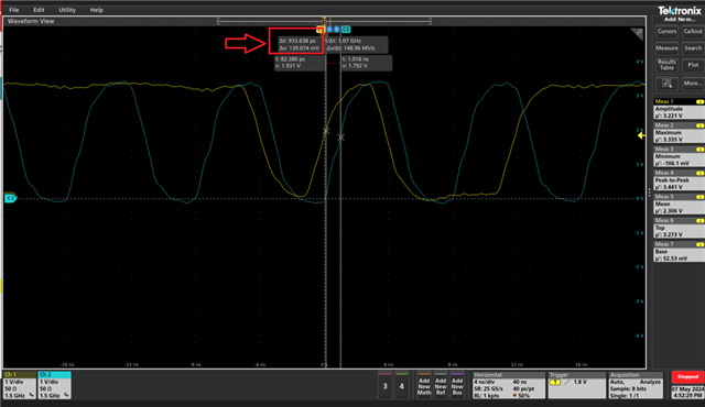

  • We tried probing the clock pins on the device and are getting nothing.  Thanks again.

  • Hi Dan,
    What exactly did you see when probing the clock and data lines? If data and clock are not offset enough then data received/sent would not be read properly.
    Just to clarify are eth0 and eth1 on your board CPSW? And eth2 is the only one that is PRU_ICSSG ethernet?
    Have you tried checking the MAC statistics with "ethtool -S eth2" for any errors or dropped packets after the ping failed?
    -Daolin

    I have taken the waveform of PRG1_RGMII_RX_CLK_& Data to understand the DELAY.
    6507.PRG1_RGMII_RX_CLK_&_D_DELAY.zip
    please take a look and let us know if you have any concerns.
    Vaibhav
    Can you clarify which signal is PRG1_RGMII_RX_CLK and which signal is DATA?
    According to our hardware team, "RGMII is dual-data so it latches data on both rising and falling edge of clock"
    If the yellow traced signal is the clock signal and the blue trace is the data signal, then the signal is definitely off as the clock should be delayed by 2ns and not the data delayed by 2ns.
    -Daolin

  • Dear Daolin Qiu,
    Yellow signal is PRG1_RGMII_RX_CLK & Blue signal is PRG1_RGMII_RX_DATA.
    Vaibhav
  • Dear Daolin,
    In the previous waveform /cfs-file/__key/communityserver-discussions-components-files/791/6507.PRG1_5F00_RGMII_5F00_RX_5F00_CLK_5F0026005F00_D_5F00_DELAY.zip, According to my observation clock is delayed by 2ns after the data transition.
    We have re-verified the delay between clock and data by setting 1nS delay in place of 2ns. You can take a look on attached waveform
    PRG1_RGMII_RX_CLK_&_Data_1nS_DELAY.zip, Blue signal is PRG1_RGMII_RX_CLK & Yellow is PRG1_RGMII_RX_DATA.
    Vaibhav

    The signals in the below scope capture (1ns delay) with blue as clock and yellow as data appear to be correct in terms of clock delayed rather than data delayed. You just need to make sure it is 2ns delay of the clock.
    I was under the impression that RX was not working properly but TX was working properly based on the previous statement below
    "Ethernet interface comes up on this interface but we are only able to transmit and not able to receive anything on this ethernet".
    One way to check if the packets transferred successfully with no errors is to check the ethtool RX statistics on the link partner where you are sending the packets. In fact, I would recommend doing this to check if transmitting packets worked without errors.
    From the ethtool statistics I no longer see "rx_crc_error_frames" but I still see the following errors. I'll have to check with an expert on the team about these errors and will get back to you later today or tomorrow.
    rx_min_size_error_frames: 1
    rx_overrun_frames: 1
    -Daolin

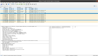

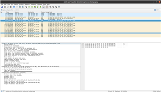

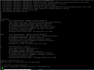

    We have tested Tx path by connecting board ICSSG1 eth2 (192.168.1.200) to external HOST PC(192.168.1.10)
     Board ((192.168.1.200)  -> PC(192.168.1.10)
     1) Please see below console capture of am64x board. Sending ping to HOST PC - 192.168.1.10
     2) See below picture which shows wireshark capture on HOST PC. It shows ARP packets coming from am64x board with IP Address =192.168.1.200 and MAC = 0A:0D:C6:7A:2A:86
     3) Below screen capture shows ARP reply.
    Attached wireshark pcapng file for detailed review: am64x pru Tx packet wireshark capture on host.zip
    Please review above and let us know if you have any concerns on the transmit path of ICSSG1 eth2 working functionality.
    Vaibhav
  • Hello Vaibhav,
    Based on your wireshark capture, it looks like after running ping from your custom AM64x board to the host PC, the ARP request (transmitted packet) was successful as the host PC is responding to the ARP request (ARP reply) and replying back to the AM64x custom board. However, on the previously shared ethtool -S eth2 on the custom board, zero rx_good_frames were observed. This indicates that the ARP reply is not received on the custom board end which explains why the ping fails.
    What is strange is zero rx_crc_errors are observed which would have been indicative of erroneous frames detected and then dropped because of the errors. Additionally, zero rx_broadcast_frames are observed which usually would show up when ethernet interface link is up and before any IP addresses are set as the connected devices would be broadcasting for a DHCP server. It seems as if full frames are not being received such that CRC errors cannot even be calculated.
    The single rx_min_size_error_frames: 1, rx_overrun_frames: 1, are strange as well because typically you would see more than just 1 single frame and see at least several rx_broadcast_frames or rx_good_frames before rx_overrun_frames show up. Do these rx_min_size_error_frames and rx_overrun_frames increment at all or stay at 1 after ping transmission?
    Could you try switching your ethernet cable with another one? I know this sounds like strange request but if the ethernet cable was damaged (one of the 4 twisted pairs was faulty) then it could be likely that the entire ARP reply frame was lost before it gets to the custom board PHY or MAC.
    To determine if the frame loss/error is present at the PHY, I'll ask Alvaro from the Ethernet PHY team to suggest how to read the PHY registers to detect any data valid/errors detected.
    Later, if we determine that no data/frame errors are detected at the PHY then the frame loss/error must be at the MAC. If this is the case, I would recommend probing the RX data and clock signals closer to the SOC and compare the results with the signals probed closer to the PHY to see if any signal distortion is happening. If it comes to this issue, I will have to consult with our hardware team for more advice on how to proceed troubleshooting.
    I appreciate your patience as we try to narrow down the issue.
    -Daolin

  • Hello Vaibhav,
    Thanks for sharing additional information including the waveform scope captures. We checked the waveforms and noticed for the RD0-RD3 with RX_CLK graphs, the time offset is <2nS. We would need to review the layout to check if for example RX trace length matching is satisfied. Can the layout files be provided for our hardware team to review?
    I checked the previously shared device tree snippet for icssg ethernet and nothing immediately looks incorrect. The only thing I noticed is that in the TI EVM dts "rgmii-id" is used for phy-mode rather than "rgmii-rxid". The DP83867_RGMIIDCTL_2_00_NS is set to 2ns delay for the PHY which make sense. We need to ask the Ethernet PHY team about whether setting this DP83867_RGMIIDCTL_2_00_NS means measuring 2nS delay on RX path.
    Can you try testing the icssg ethernet interface at 10Mbps? The idea is to configure to a lower speed to drop the RX clock rate down to a lower speed, to help make the MAC more tolerant of any timing issues. The goal is to check if rx_good_frames are detected or at the very least if we can see more than just a single rx_crc_error. You can do this by using "ethtool -s eth2 speed 10" and make sure to do the equivalent for your host PC/link partner.
    DP83867 PHY should technically work fine for icssg ethernet and is likely not causing the current issue.
    Additionally, is this issue of "PRU ICSS ethernet port only RGMII transmitter path working and RGMII receiver path is not working" observable on multiple boards or just one?
    -Daolin

  • Dear Daolin,
    2nS is ideal delay for batter setup & hold time of RGMII signal. However, minimum 1nS setup & hold time of RGMII signal is acceptable by AM64xx & PHY.
    I have attached PRU_ICSSG_Ethernet_Length Match report.zip  & Layout.zip image of the same for your reference.
    please let us know, if you have any concern on the same.
    Vaibhav
