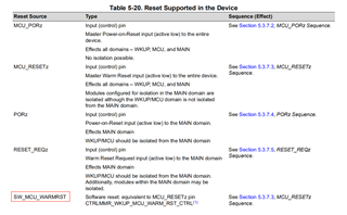

Hi, experts ,
On the A core I'm trying to go warm reset by writing registers, but the device is not warm reset, why is that?
devmem2 0x4301817C w 0x60000

Hi Bing,
If you are using Linux please use the command 'reboot'. This gracefully resets the A72 and you don't need to access the hardware registers directly.
U-Boot support 'reset' command if you wish to reset form U-Boot.
