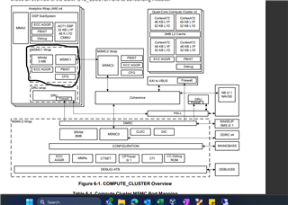

We are trying to develop a kernel that works on C7 DSP using streaming engine, for reduced memory complexity we want to use MSMC 1, extended memory which as 3MB capability.
The idea is to move the images in DDR to MSMC and back from MSMC to DDR using streaming engine. Could you provide us any sample examples that could help us achieve this task. We looked at C7 Training material that has information on how to use streaming engine, but that does not mention anything about streaming the data back to DDR memory.
As mentioned in the image above, SE cannot be used to write instructions but to input instructions. what does this exactly mean in terms of data streaming, please elaborate.
Here is the MSMC we want to invoke for the kernel:
Thank you.

    Its the option two. We are developing a custom kernel that generates a 2X2 CFA pattern for a 4X4 RGBIR image sensor. This kernel uses convolution and other mathematical operations to be processed on raw images in C7.
    DDR -> MSMC -> C7x -> DDR (This way instead of using the 512KB L2 cache for C7, we can take advantage of the 3MB space available in MSMC directly to operate in C7 by skipping L2)

  • The only reason I want to use MSMC instead of L2SRAM is that the space available in MSMC1 is 3MB compared to 512KB available in L2SRAM. This amount of space can help us perform the kernel process more quicker.

    To get a better understanding between SE's interaction between L2SRAM and MSMC, I would recommend looking at Figure 12. UMC Interfaces and Block Diagram in the C71x DSP Corepac Technical Reference Manual.
    1. I understand that you've included L2SRAM in order to use streaming engine, but is this a necessary step to use SE?
    3. Can we use SE to move data from MSMC to C7 at all?
    L2SRAM is technically not necessary, SE can read from MSMC or DDR as well. However, SE is tightly coupled with L2SRAM and will have the least amount of latency and maximize throughput when reading. If you look at the diagram and how L2SRAM is organized into 4 banks, you are able to have 2 512-bit read paths (using both SE) to the C7x core. However, if you look lower at the diagram to see the connection between the UMC and MSMC you have only one read/write path. So you would only get half the throughput in reading from MSMC (as well as some additional latency).
    From a write perspective there is only one 512-bit write back from the C7x core, so the choice between using L2SRAM and MSMC is more minimal. In the case above, it might be worth writing to MSMC for the output due to the larger size as you have mentioned, and also to maximize the use of L2SRAM for the input processing.
    Let me know if that clarifies this for you. If you scroll past the figure in the document I mentioned, it explains the interface in more detail. Thank you for your patience on this topic.
