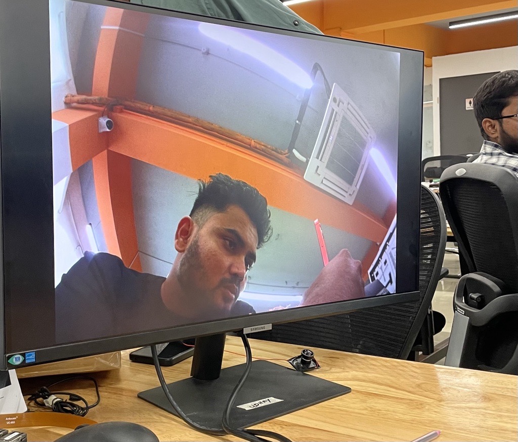

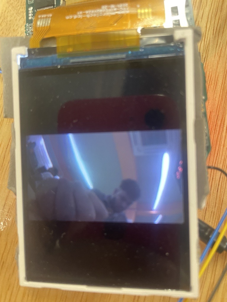

I am streaming sensor to DPI display directly but somehow the quality is reduced with NV12
but if i stream hdmi directly the image quality is good

gst-launch-1.0 v4l2src device=/dev/video-rpi-cam0 io-mode=5 ! queue leaky=2 ! \
video/x-bayer, width=1640, height=1232,format=rggb10 ! \
tiovxisp sensor-name="SENSOR_SONY_IMX219_RPI" \
sink_0::device=/dev/v4l-rpi-subdev0 dcc-isp-file=/opt/imaging/imx219/linear/dcc_viss_10b_1640x1232.bin \
sink_0::dcc-2a-file=/opt/imaging/imx219/linear/dcc_2a_10b_1640x1232.bin format-msb=9 ! \
video/x-raw, format=NV12 ! queue ! kmssink driver-name=tidss sync=false
I am using above the pipeline
Is that because of tidss driver issue?
