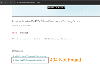

4. Some link related to am437x are invalid such as:
then I have found the similar issue related to my exactly problem from this post:
https://e2e.ti.com/support/processors-group/processors/f/processors-forum/1306470/am3358-linux-devkit-compile-code-failed-for-ti-processor-sdk-linux-am335x-evm-09-01-00-001
