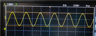

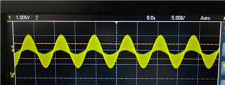

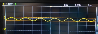

    I added what you provided and got a strange waveform.
    The frequency of the waveform is 125Mhz, which is expected,
    but the amplitude of the waveform is fluctuating, which is strange.
    What is your opinion on this phenomenon?
    The waveform is as follows:
    Continuously detected waveforms:
    Stopped waveform 1:
    Stopped waveform 2:
    Above, thank you

    During the VH startup, from the power-on to the uboot, the clock is always 125M. When the Linux kernel is started, the waveform changes:
    1. When I set speed = <1000>; When the Linux kernel starts, the clock changes to a waveform with ever-varying amplitudes (top image in the earlier comment), with a clock frequency of 125Mhz and amplitudes varying between 3.3v and 1.8v.
    2. When I set speed = <100>; When the Linux kernel is started, the clock changes to the state after the superposition of the 125M and 25M frequencies.
    From the perspective of the phenomenon, before the Linux kernel started, there was a stable 125Mhz clock, but after the kernel started, an additional waveform was added, and this waveform followed my configuration.
    Looks like two waveforms superimposed.
    The expectation should be that there will always be only one waveform, and my configuration should load the original default configuration, but look like it is not overwritten, but added.
    Can this phenomenon be explained?

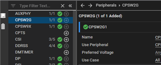

    3. How to set my RGMII operating voltage?

    Please refer to below from sysconfig file.

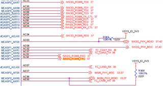

    I captured the clock signal on SW2G_RGMII_TX_CTL (PIN AF35) (there is a screenshot of the schematic in the problem description)
    I'm sorry, but I can't find the option in your screenshot in sysConfig, can you explain where it is?
    Clock should be from RGMII_TXC is the clock signal of RGMII from MAC. I hope above comment would be typo as you have confirmed clock is coming as per configuration.

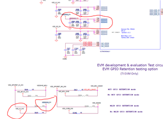

    Regarding the signal level, check your schematic, what is the voltage supplied to VDDSHV2 pins of TDA4VH. If supplied voltage is 3.3V then you may get output signal level as 3.3v is not it will be 1.8V.
    Please refer below, TI EVM schematic for refence. Also, find full schematic details from EVM page on ti.com
    Sudheer
    Sorry, my mistake. The pin I measured was SW2G_RGMII_TXC AL34
    I have confirmed that the voltage of the VDDSHV2 pin of TDA4VH is 3.3v.
    I may not have expressed myself clearly, regarding the option to set the voltage, can you tell me in which group it is?
    Please refer to Power Domain options form Sysconfig tool.

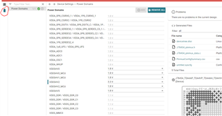

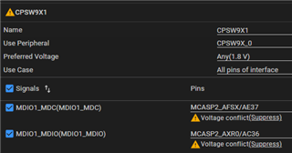

    when I set VDDSHV2 pin of TDA4VH is 3.3v. There are two warnings:
    This is shown in CPSW9G, as VDDSHV2 is common for CPSW9G/CPSW2G.
    In case of CPSW2G it will be for RGMII/RMII lines as well along with MDIO lines. Whereas In case of CPSW9G it will be only for MDIO lines Port Lines will be Serial Lanes from SerDes which are 1.8V.
    As you have selected VDDSHV2 as 3.3 so, it showing conflict in CPSW9G window, This can be ignored no Issue. As CPSW9G supports 3.3V.
    Best Regards.
    Sudheer
