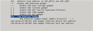

We are using the Jacinto TDA4 J721E EVM board and we are trying to use the USB Ethernet gadget driver.
In theory this driver allow to create a new network device to load images using the tftp or nfs protocols.
We enabled in the corresponding u-boot config this feature but this is not initializing any new network apart from the one that is already present (eth0).
After to enable this driver, is supposed that u-boot should list a new device named "usb_ether" using the "Net" command.
Do you know if actually this gadget driver can be used? if yes, could you provide correct configuration to enable this feature?

  • Hello Diwakar,
    Thanks for your reply and support.
    Actually what we did is to edit the default configuration that the uboot provides for the j721e boards. Running the menuconfig we enabled "USB Ethernet Gadget" with the RNDIS protocol, but as you can see at below log there is no new ethernet devices in the list:

    We also saw that in the device tree provided (k3-j721e-common-proc-board.dts), there is one USB3 device that can be used with the OTG/Peripheral mode, and seems to be linked to a Cadence Sierra Phy, how can we use that?
    We tried to enable USB3 port at uboot using the "USB Start" command, but we only can see something configuring it as "host", but never in peripheral or OTG mode.
    Oscar

  • Hello Diwakar,
    I did the changes at the k3-j721e-common-proc-board-u-boot.dtsi file and the uboot is able to detect a USB mass storage device after the USB Start command. So, this is working, but as a Host.
    Problem is that this configuration can not be used to emulate a Ethernet port as a client, which is the feature that we wanted to test. I saw this comment in README.usb file:
    Note: USB Host Networking is not the same as making your board act as a USB
    client. In that case your board is pretending to be an Ethernet adapter
    and will appear as a network interface to an attached computer. In that
    case the connection is via a USB cable with the computer acting as the host.
    This is just what we wanted to use, and what we think that USB Ethernet Gadget driver is doing. Do you know how to enable USB3 port for that particular case?
