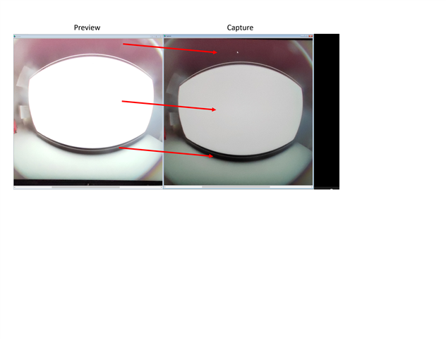

Hello TI team,
We have query regarding the brightness difference in preview and in YUV.
In lowlight scenarios what we see in preview and in YUV dump have luma difference. Both are checked on the same display.
Output from TI TDAV4VM is connected to Display monitor using DP cable.
TI YUV dump converted to PNG.
TI preview snapshot

  • Hi
     We tried some experiments for the same,
    YUV image was converted to RGM and then gamma value of 2.2 is applied (which is used in tuning), then we can see the line noise same as in preview.
    Preview Snapshot
    Snapshot of gamma applied RGB
    Is there any additional processing done on the preview?
    Adding on, if the planes of the images in YUV was not dumped properly, it should show issues in other conditions (bright and room light) which we haven't observed till now.

  • Application is not modified. We are using as such.
    While dumping using DCC tool have same problem.
    The preview its brighter, so we see the line noise and in YUV its completely dark.

    If so, the images which i shared earlier are on 0.2 lux. (<1lux).
    On other lighting scenarios, bright light and room light, YUV dump and preview don't have much difference in brightness. Only on lux intensity <1Lux we observe the issue of brightness difference.
    Sub 1lux.
    Preview ---> bright and can see line noise.
    YUV dump (NV12 format) ---> Dark

  • So, if we change the lux level of the scene it responds to a change but the delta between preview and capture remains. The capture is always more contrasty compared to preview, which in effect makes teh darker regions look dark. In preview mode, the images looks like it is having an offset and blacks look greyish and the images look like there is a lot of flare.
  • oh that's lot brightness difference.
    So from VISS, does it directly go to display only? and is this eDP display? have you checked with multiple displays and confirm the output is same for all displays? Just wondering if this is coming from the display.
    Also wondering if there is any CSC difference that can cause brightness, lets first check the other parameters.
    Brijesh
  • The capture is direct output from VISS and the preview is VISS->Display Sub-System->Display through DP connection

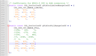

  • If incase display is doing some post-processing then also it should not be a problem because we are viewing both Capture and Preview on the same Display which will apply same level of processing on both. Can you check whether preview and Capture looks same at your end.
  • I think our DSS code uses BT601 CSC coefficients, so if your monitor is using some other coefficients, then there could be difference, other than this, i dont se any other difference
  • If the DSS is still using BT601 format then we are using reduced signal range like (16-235) which causes clipping as our capture NV12 format is of full range (0-255). Could you please confirm in j721s2 which DSS is being used. If this is the case then preview should look dark and capture should look bright but we see opposite behavior. How to check the what coefficients are being used by a monitor.
  • Not sure which coefficients are used by your monitor. I would suggest checking int monitor specs.
    What do you mean by what dss is being used? i did not get the question.
    Brijesh
  • I mean in j721s2 TDA4 VPAC3 what is the signal range being used by DSS is it BT601 (16-235) or BT709 (0-255). I have heard from ISP team that signal range  (16-235) is being used by DSS in TDA3 which is the previous version of TDA4 but it got updated and DSS is using full signal range (0-255) in TDA4. It got updated or not.

    How to change DSS signal range to 0~255? The default DSS settings using 16~235 range only
    Ravi.
    As communicated over email, i think DSS output is in  full range, one difference could be, VISS is using BT709 coefficients whereas DSS is using BT601 coefficients, can you please try changing it in one of the place and make it similar?
    Brijesh

    There isn't any DSS log which will print these coefficients. Most likely we would have to dump register and confirm the same.
    I think it is easy to find the CSC registers for Vidoe pipeline in TRM, like below. Can you please save these registers using devmem2 utility?
    Brijesh
  • We just did a swap of the DSS coefficients in the file csl_dssVideoPipe.c (as shown below). and we can see now the YUV dump image is matching with the preview in monitor.
    Can you take  a look on this?
    Aparna
  • Aparna,
    That's strange.
    Let me check the YUV2RGB settings for full range output in bt601.

  • Aparna,
    As Gang suggested, Can there be issue due to viewer that you are using? Can you try changing setting in the viewer?
    Brijesh
