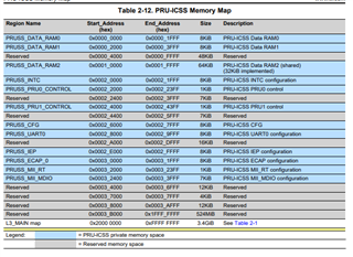

  • Hello Sebastian,
    Could you provide the a dump of the ICSS DMEM?
    FW team has the following idea:
    "There is a port status offset which gets disabled during link down and gets enabled during link up. May be this is not done correctly in polling mode."
    -Josue
  • Hello Josue,
    Sorry for the delay, I was out for a week and I got swamped when came back. How can I get the dump you ask? I do have an XDS debug probe, but I don't have a lot of experience with these devices.
    Also, in which situation should I get it? With the polling or with the interrupt mode?
