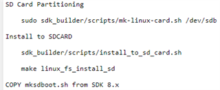

  2. FLASHING
    1. The v09x SDK does not include the mksdboot.sh script.
    2. The documentation covers aspects related to the rootfs. Could you provide guidance on flashing the BOOT partition?

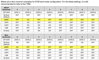

  3. EVM Boot Mode.
    1. The documentation includes instructions for setting SD Boot Mode, XSPI Boot Mode, and UART Boot Mode. How do we set the eMMC Boot Mode?

    FLASHING
    There has been a renaming from mksdboot.sh as create-sdcard.sh
    RTOS SDK does not support eMMC boot by default.

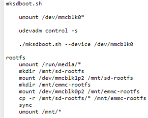

    create-sdcard.sh is not working on the EVB. I used mksdboot.sh for partitioning.
    I executed the commands below.
    1. rootfs
        umount /run/media/*
        mkdir /mnt/sd-rootfs
        mount /dev/mmcblk1p2 /mnt/sd-rootfs
        mkdir /mnt/emmc-rootfs
        mount /dev/mmcblk0p2 /mnt/emmc-rootfs
        cp -r /mnt/sd-rootfs/* /mnt/emmc-rootfs
        sync
        umount /mnt/*
    2. BOOT(on u-boot)
        => mmc dev 0 1
        => fatload mmc 1 ${loadaddr} tiboot3.bin
        => mmc write ${loadaddr} 0x0 0x400
        => fatload mmc 1 ${loadaddr} tispl.bin
        => mmc write ${loadaddr} 0x400 0x1000
        => fatload mmc 1 ${loadaddr} u-boot.img
        => mmc write ${loadaddr} 0x1400 0x2000
    When I switch to eMMC boot mode and reboot, it doesn’t start up.
    JK

  • Hello Diwakar,
    The order in which I tested is as follows.
    1. INSTALL to SDCARD
    2. BOOT from SDCARD
    3. Reboot and go to u-boot shell
    4. Turn off
    5. Booting.
    JK
